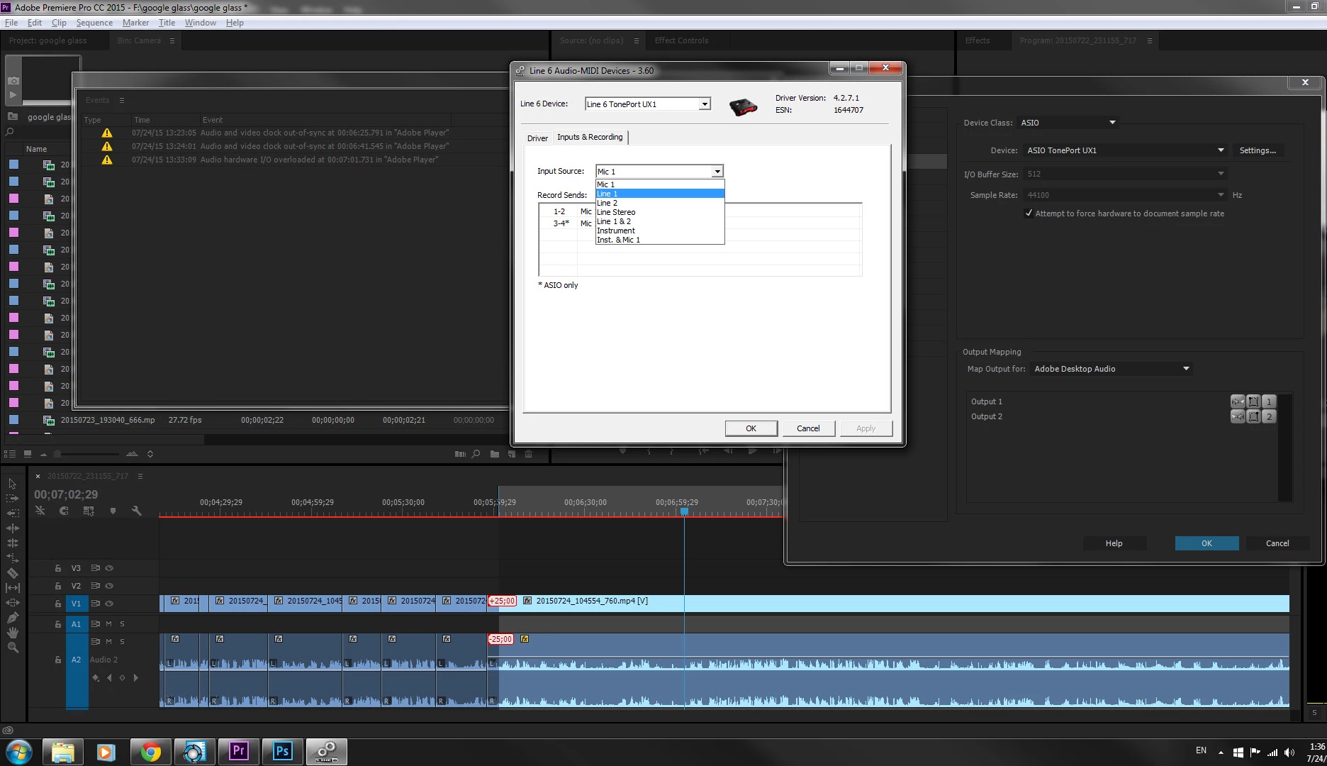

    Hi All,
    There have been a few successful workarounds for this problem. You can:
         * Disable the input device listed in Default input through Device Manager (so that the default input device is "No Device Available").
         * Change the input device to something like Line in or Mic in and then plug a device into that input (even a set of headphones will generally work for this)
         * Or, install Asio4All to provide an alternative to the MME driver listed under Device Class.
    All of these options have been successfully used to resolve this issue. The Premiere Pro engineering team is aware of and is actively working to resolve this issue. Hopefully they'll have something soon!

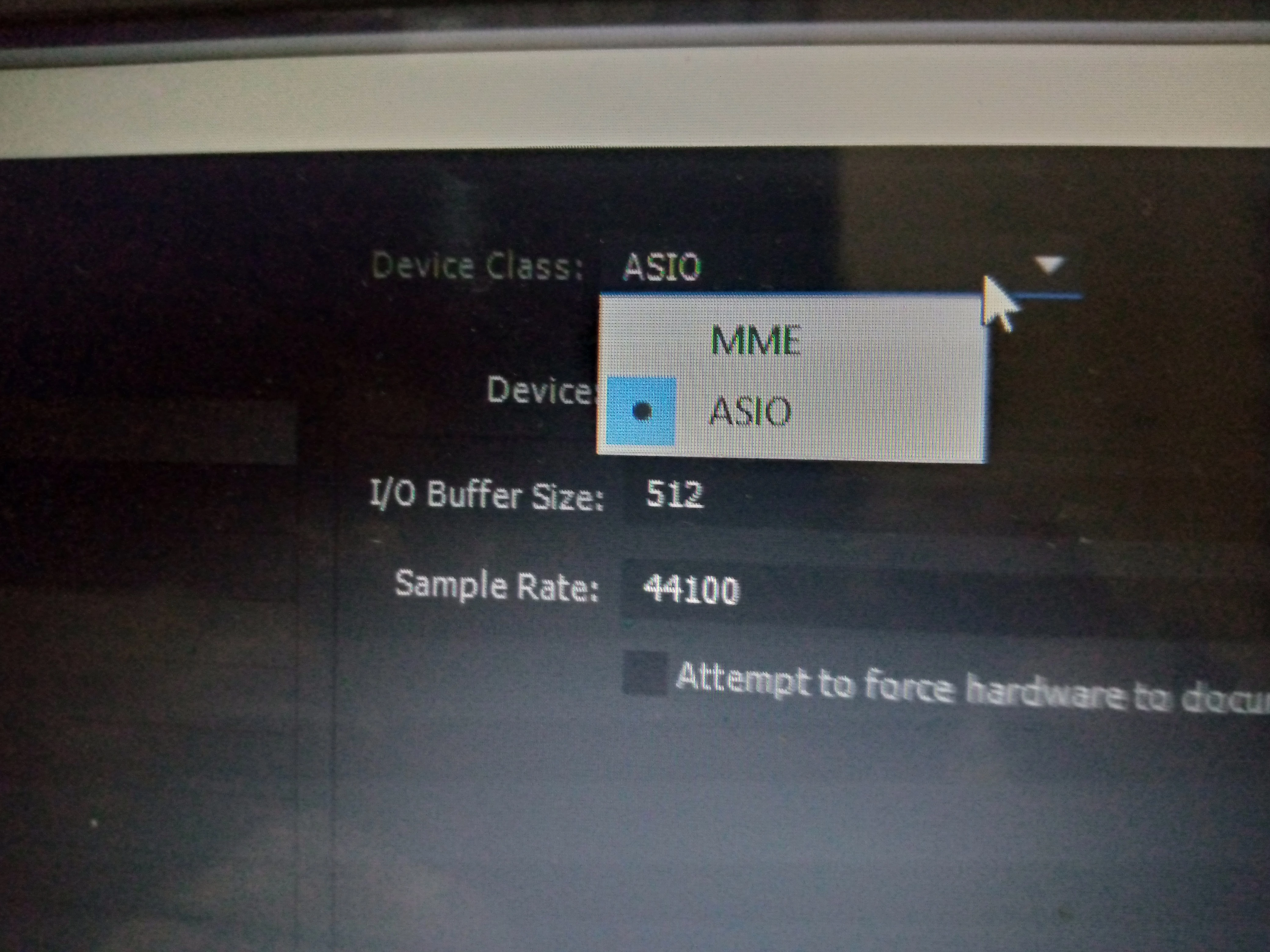

    I know this is an old post, but I found it via Google for the issue at hand. I tried installing the ASIO4All file and it made no difference - before AND after, selecting ASIO instead of MME in the Audio Hardware just muted the sound.
    I found the answer by changing the default input from Digital-In to any of the other options I had set up. However, why this was happening, I've no idea. It was fine this morning, then just changed. At the same time, all my 'open recent' projects had cleared and I had to reopen them again so they showed up there. What a bizarre program.

    Asio by the way makes it worse. It plays back without hiccups but the audio did not match up with the video. Not good.

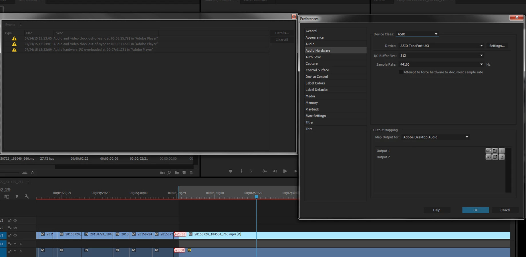

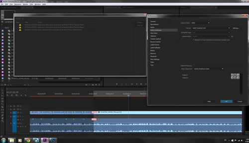

    July 24, 2015
    SORRY FOR BAD SPELLING
    the movies play fine in windows media player so its not that
    working on gpu/cpu
    i canot select no input its not on the list
    via the ASIO settings i select mic and line in but it didn't help the problem
    same problem with gh4 mov 4k and 1080 /canon 5dm3 1080 /gopro 1080

    July 24, 2015
    Try the below steps one by one and check the outcome. First try stereo mix and if it doesn't work try Virtual audio cable.
    a) Check the Sample Rate in Premiere Pro CC 2015 Preferences>Audio Hardware
    b) Go to Sound menu in windows and under Playback tab, select the playback device and in Properties>Advanced Tab choose lesser sample rate as compared to Audio Hardware preferences Sample rate in Premiere Pro CC 2015
    c) Set the Stereo Mix sample rate in the same way but equal or greater than those of Hardware Preferences sample rate in Premiere Pro CC 2015.
    d) Go to Premiere Pro CC 2015 Preferences>Audio Hardware and set the Master clock to Stereo Mix, set Virtual audio cable or Stereo Mix as default input and Playback device to default output.
    Note: Clicking on “Settings Tab” in Premiere Pro Preferences>Audio Hardware takes you to “Sounds”
    Steps for Virtual Audio cable.
    a) Install virtual Audio cable on your machine from: http://virtual-audio-cable.en.softonic.com/
    b) You can also enable “Stereo Mix” by going to “Sounds” menu in windows>Right click to select  “Show disabled devices. Virtual Audio cable is a third party sound card
    c)
    Under Audio HW setup set Virtual audio cable or Stereo Mix as default input device and set master clock to virtual audio cable or Stereo Mix and try to playback.
    Also, this issue has been fixed in the upcoming 9.0.1 update released soon. So, if possible (Audio is not out of sync) turn off the notification from Premiere Pro>Edit Menu>Preferences>General>Shoe event Indicator
    //Vinay
