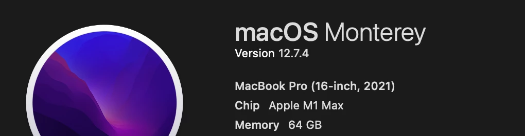

These are the versions I'm on.
Thanks for your help.
