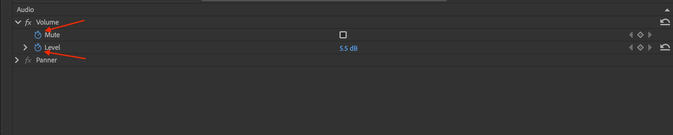

I was having this same issue in PP 2025. In the effects control panel, I noticed that on one of the clips that I was trying to paste attributes to, the keyframe "buttons" were active on Mute and Volume. I was only trying to copy and paste an overall volume level change, not a keyframe timing change of the volume. I clicked both the Mute and Volume keyframe "buttons" off and viola, I could now copy and paste attributes again.

This worked for me as well, thanks!
Strangely, when I clicked in a bunch of audio keyframes in the timeline and tried again, those copied and pasted fine. Seems like one of those issues that just needs to be toggled a bit to fix?
