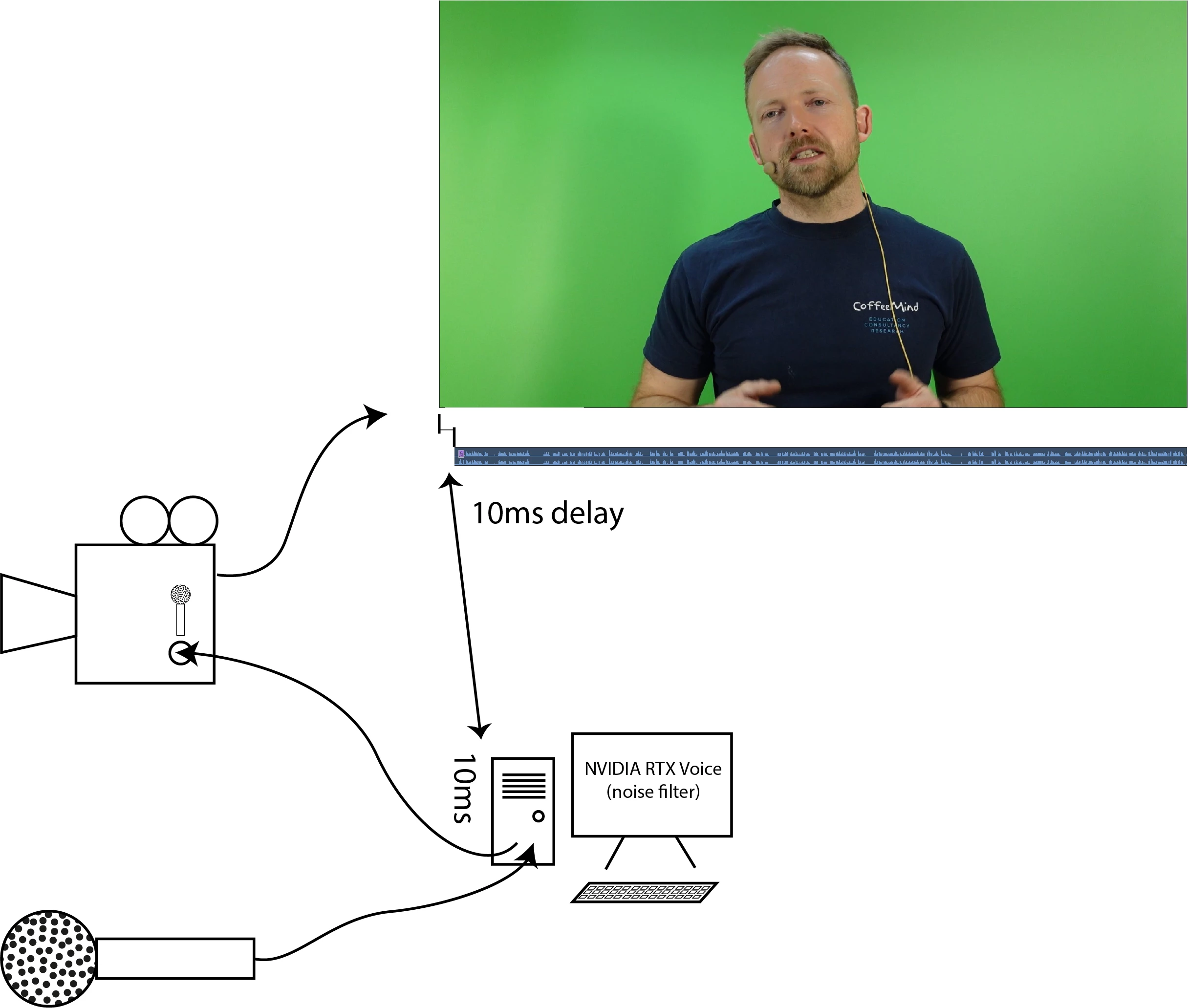

I have a strange problem that I would like to solve by adding a filter on the master clip as the problem is constant related to all clips I import from my green screen studio as illustrated below
I have my studio in an extremely noisy environment and I would like to NOT have to fiddle with recording on a separate sound recorder and merge the clips on Premiere Pro, so I have found this solution where I run the audio from the microphone through a computer running NVIDIA RTX Voice and then the cleaned audio runs into the camera, so that the sound is added to the video live as it is recorded. This way I can start edit right away in Premiere pro as the sound is exactly how I want it without noise.
BUT the sound is some seconds dealyed as the computer takes a few milli seconds to process the audio signal.
Is there some kind of audio filter I can add to the master clip that will constantly SHIFT the timing of the video and sound so that they run in sync?

You need to make the audio 10ms earlier so you want the opposite of delay. You could edit the video and then slide the complete audio earlier, or as 10ms is only about 1/4 frame (PAL 25i), that is far better sync than any broadcast or youtube video, I would ignore it. The only time you need closer audio sync is when you are adding audio track together.
