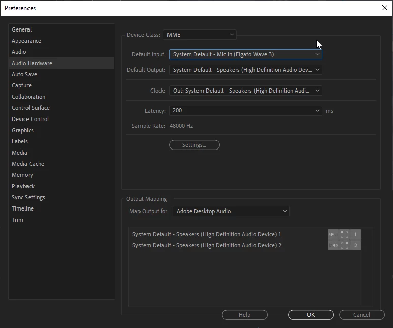

Apr 28, 2023 3:57 PM UTC
Here are the screenshots of the Windows PC settings.

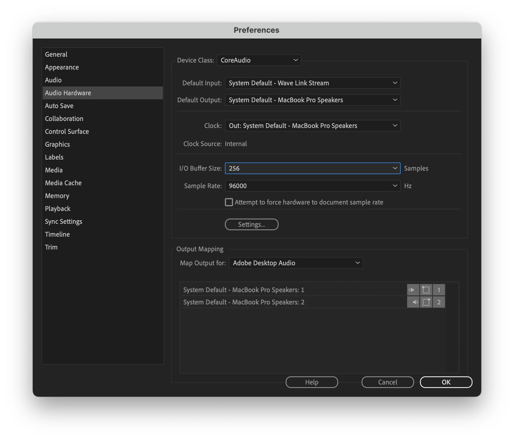

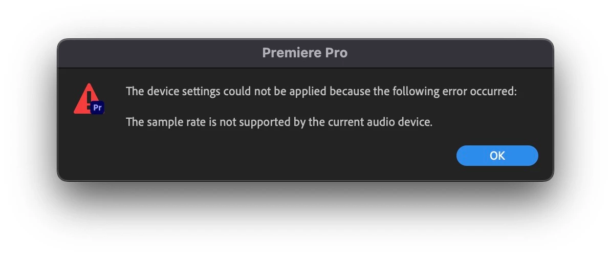

Hi, thanks for the continuous help.
Yes, Wave Link Stream is software to a USB microphone I have (Elgato Wave Link 3), however it isn't plugged into my laptop, in fact, it hasnt been in a long time. When I switched the Input to "no input", the problem got a little bit better. So I went in to change the sample rate and buffer size. The sample rate was already on 48000 when I went in there, but obviosuly wasn't in the screenshot. So I changed the input back to "Wave Link Stream", and I got an error message saying that it wasn't compatible with the current sample rate. I also now don't have the option to go back to 96000. So that must be something with the microphone. I rarely use that mic with my laptop at this point, so maybe that could've caused an issue?
Also, I don't have the option to increase the buffer size to anything higher than 256 (my only options are 16, 32, 64, 128, and 256). This is no watter which input I select.
Another random thing I noticed, which may or may not help, is I get a little caution triangle when I select my AirPods and the Input that states "The Maximum sample rate is too low, choose another device". It doesnt give me an option to increase the sample rate. Not sure what that means, or if it's even relevant, so I'm sorry if it isn't haha. Figured it might be good to share.
I've also attached a screenshot of the error message if that helps at all. Apologies for not trying with the PC, I'm still on the road. I should be home tomorrow to try these same methods on that setup as well.

Apr 27, 2023 8:47 PM UTC
Thanks  I'm unfamiliar with "Wave Link Stream", it is a piece of software that you can use to capture audio I am assuming?
Can you try two things for me?
1.  Set "Preferences>Audio Hardware>Default Input..." dropdown to "No Input". and see if that helps.
And if it does not help, try this next:
2. Set "Preferences>Audio Hardware>Sample Rate..." dropdown to 48000 (48K), and the "I/O Buffer Size" to 512.
Please let me know if either of these help.  If they do I know that I can then narrow down a large set of variables in order to generate a bug.

Apr 27, 2023 8:37 PM UTC
It's happening on my 2021 M1Pro Macbook also, which I'm working on now.
Here are screenshots from the Macbook. I will get screenshots of the PC when I can get back to it.
Thank you!

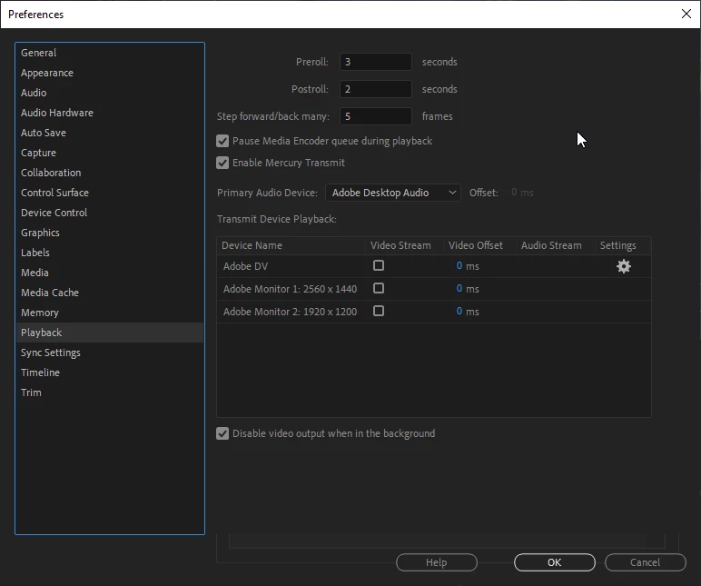

Apr 26, 2023 7:14 PM UTC
To eliminate some variables, can you please poast a screen shot of both:
"Preferences>Audio Hardware..."
And
"Preferences>Playback...."
Matt
