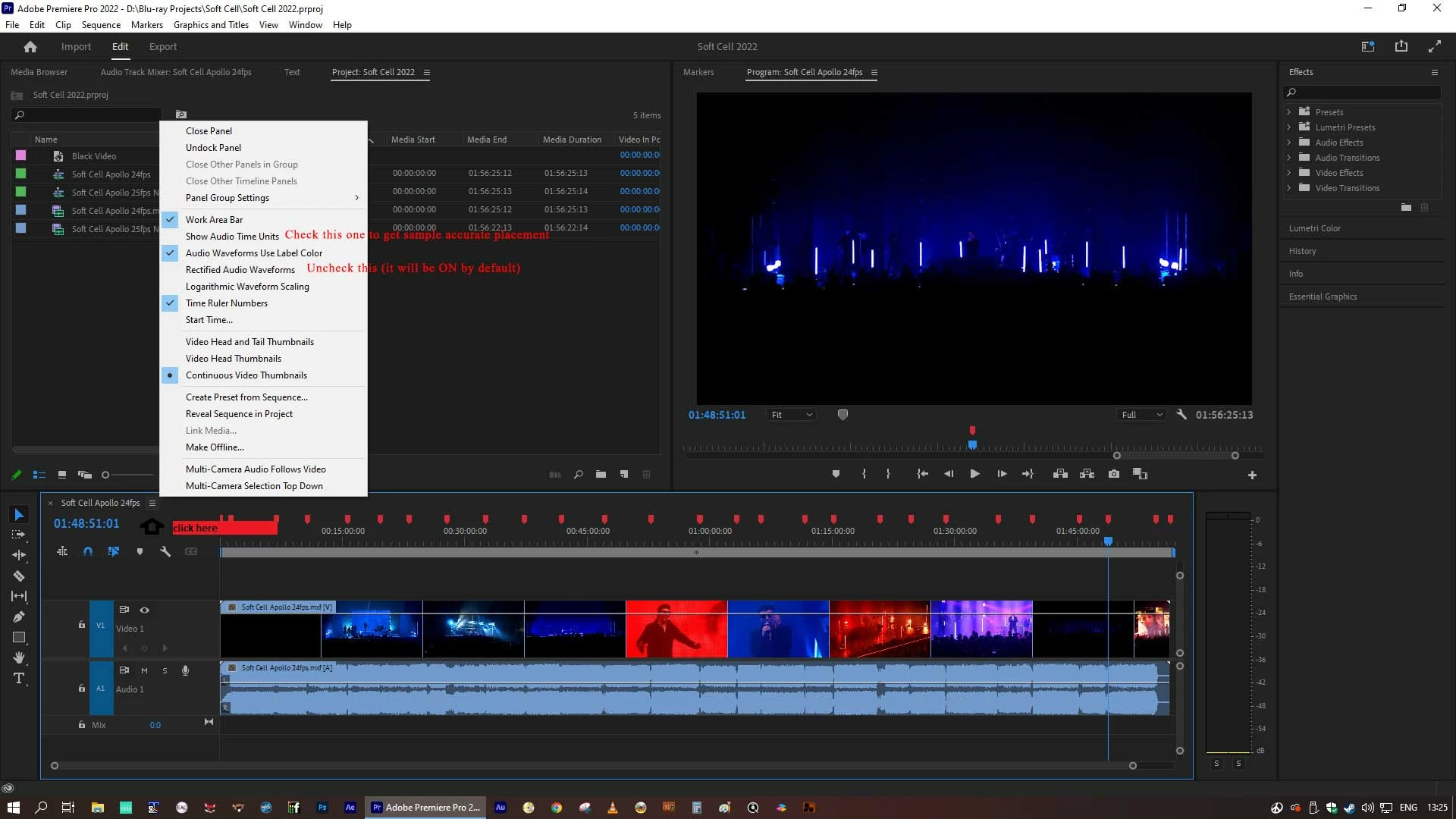

Have you tried resetting the Audio display from Rectified (the default) to Waveform, and aligning up to the peak of the slate spike? The screenshot below shows you what to change in order to get sample accurate placement rather than just frame accurate
