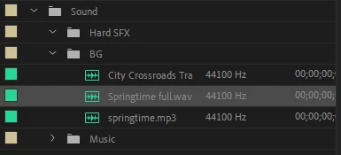

My Timeline preferences for Pr Pro are set to default mono, stereo, and 5.1 audio tracks to Mono, with Multichannel Mono Media set to "Use File." My question is, why is it that when I drop audio clips into my timeline, they appear as dual mono, on two separate tracks, with an "R" and an "L" on each track (I'd also like to point out that the 2 separate waveforms of each clip seem to have very small but appearent differences). The "R" and "L" throw me off becuase that indicates stereo, right? Also, I understand that when I left click the audio clip in the project panel, and select modify>audio channels, I can change that to only import on one track, but still the imported clip has an "R" or "L" on the bottom left corner.

Attached are screenshots of my project panel and timeline where I drag and drop "Springtime Full.wav" into my timeline. Preferences are set to default mono, stereo, and 5.1 audio tracks to Mono, with Multichannel Mono Media set to "Use File." The bottom photo shows the "L" and "R" in the bottom left corner of the clip.
I hope I did a proper job demonstrating my issue and I appreciate the time taken to view my post. Essentailly, I am looking to edit mono audio, but am unsure how to do so. Do I have to edit both clips? Or is it okay to delete one and edit from there? Do I need to alter my preferences?

With your preference setting for multichannel mono being use file, yes, PrPro is being told to do dual mono. It sees multi-channel audio, so it goes to the multichannel audio preference, sees 'use file' as set, and creates multi channels of mono.
