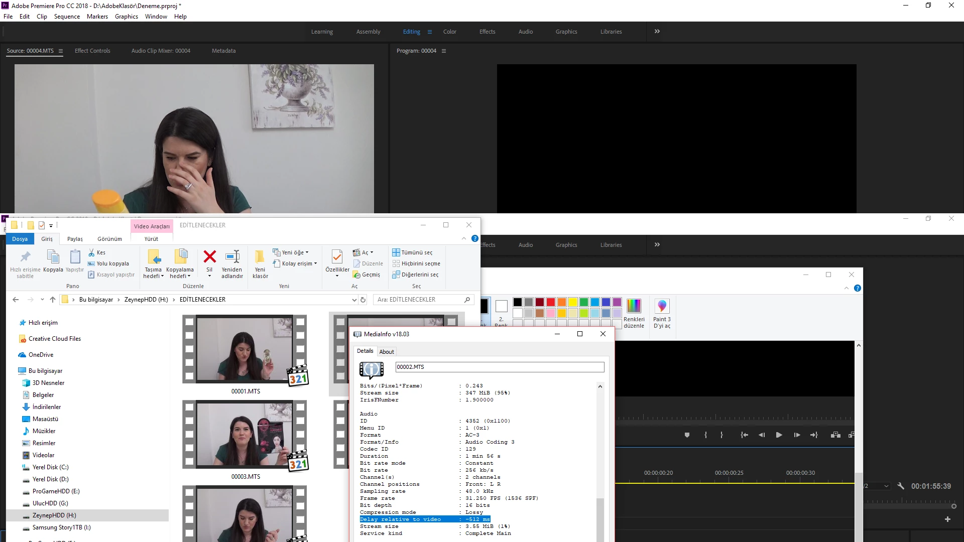

I've tried Media Encoder without success.  This problem just cropped up for me in the last couple of months after a PPro update.  Now .MST and .mp4 videos that play with synced audio in other players are out of sync in PPro and I have to manually adjust the audio timing.  I am guessing that maybe a codec has changed somehow, but haven't found the answer yet.
