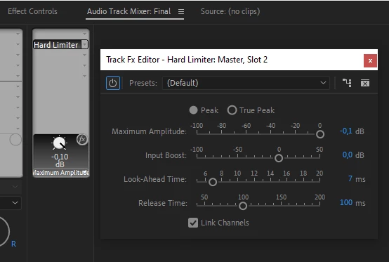

What happens if you use the Audio Track Mixer and add the Hard Limiter to the Master track? (Double click on "Hard Limiter" to open up the dialog below.)
Just tried that. Same problem. Sounds fine on timeline, still hear popping in the final rendered output.
