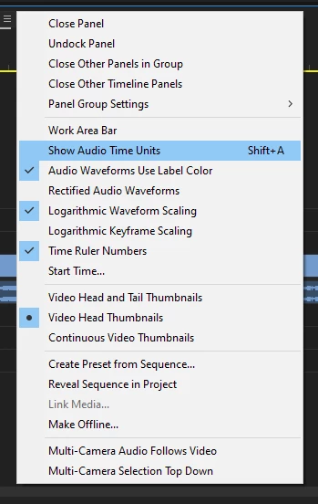

  • I would have updated Premiere Pro to the latest version, 13.1.2, and try to see if the problem persists.
  • Try to set the timeline to Audio Time Units by clicking on the hamburger menu on the timeline and then shorten the transitions to let´s say 00:00:00:00010. They don´t need to be longer to fix zero crossing issues.
Updated to 13.1.2 and the problem seems to have gone away (it's a different project but the popping is no longer there). Fingers crossed this has fixed it, will post back here if not. Thank you for your time!
