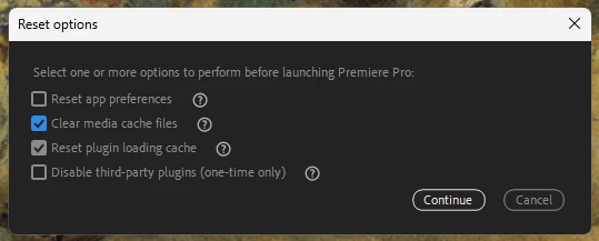

Yes, i have seen it before. Almost all times it has been solved by clearing the media cache files. Launch Premiere Pro while holding down the Shift-key will give you the dialog in the attached image. Check "Clear media cache files" and click Continue.
When you open the project again, don´t do anything until all media has been loaded and conformed. (Watch out for the blue progress bar in the lower right in the UI.) When done, try now and see/hear if the audio still has issues.

It worked! Thank you so much! Do you belive it is safe for me to uppgrade to the 24.5 version again or do you think the problem might appear again?
