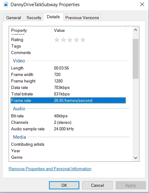

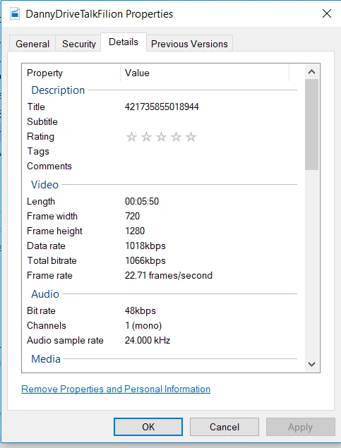

    I think I have discovered part of the problem:
    Both videos are showing frame rates that are NOT 24 fps. They seem to play fine when I double click on them, VLC I gather compensates for the weird frame rates. So now the issue is: Can I get Premiere Pro CC to convert these frame rates to 24fps?
    Stan Jones
    September 8, 2018
    Variable Frame Rate (VFR) support was added in a relatively recent PR update. What specific dot version of PR are you using?
    Generally, they would just not import. So you probably have a version that supports it.
    How are you creating the sequence? Your audio is also not a typical setting. So be sure you create the sequence by dragging one clip to the "new" icon.
    I don't know enough about the new PR methods for VFR. Don't add the second clip in the beginning. See what you get with separate sequences, one for each clip.
