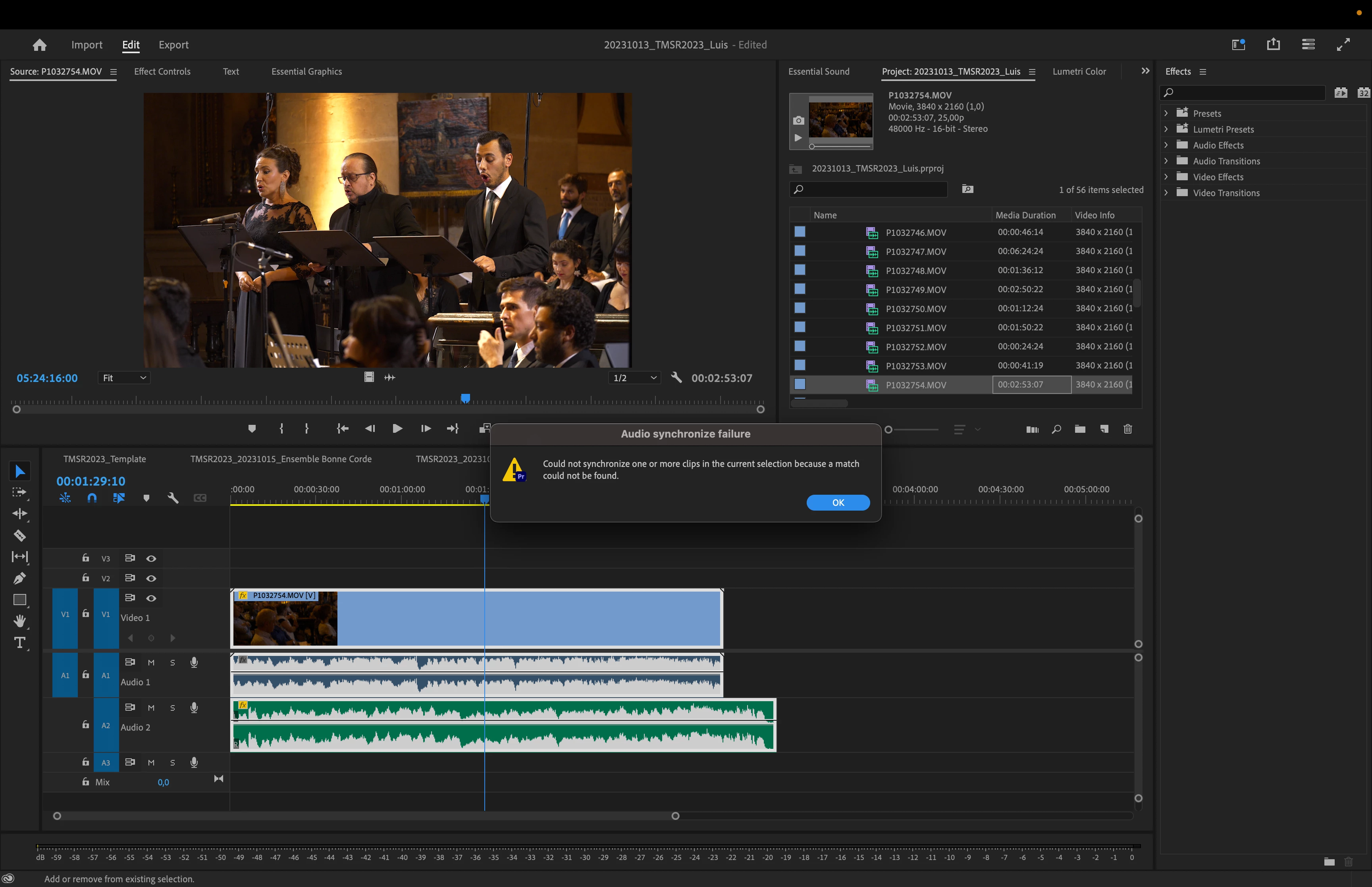

Hi there!
I keep getting this "Audio Synchornization Failure" message, when I try to sync the audio capture by my field recorder and the footage from my camera.
Both have audio set to 48000Hz, 16 bit stereo, as well as the timeline.
I've boosted the gain from the audio recorder by 16 dB (it's now at 6dB).
The captured sound is complex (choir, solo singers and orchestra), and some of the audio captured by the camera (for reference) is a bit distant.
Still, I can't understand why this Auto-Sync function is not working.
Is it a bug? Is it me being dumb? Both?
Thanks in advance for any help!

I'm only using one camera, but I tried a multicam timeline after reading your tip.
Synchronize is greyed out.
Moving back to the normall timeline, I now have + 19 dBs on the A2 track.
It synched the first clip, then it showed the same message again.
The audio is clear on both tracks. Can't understand this.
By the way, I forgot to mention:
Premiere Pro V 24.0 (build 58), running on a MacBook Pro 16", Apple M2 Max, 32 GB, Ventura 13.4

Premiere needs the audio to be relatively close in gain. Your A1 and A2 tracks have different waveform levels. Make one closer with gain applied in the Project panel, then it should work.
And you're using multicam to do the join, I hope? It's the 'correct' process in Pr for this work.
