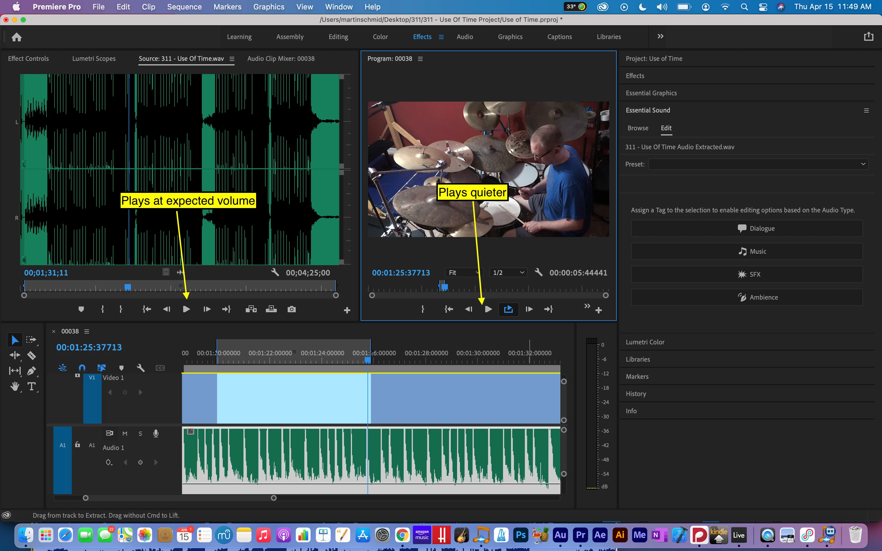

Hi.. I've noticed that audio is noticably lower once brought into premiere vs. when played by itself.
E.g., on MacBook, if I play the track in Ableton or QuickTime, the level sounds the same between the two.
However, once I bring the audio into Premiere, it seems like its about 10dB lower.. and subsequently lower when exported from Premiere.
What could be causing this?

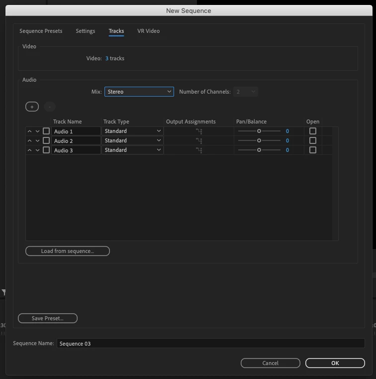

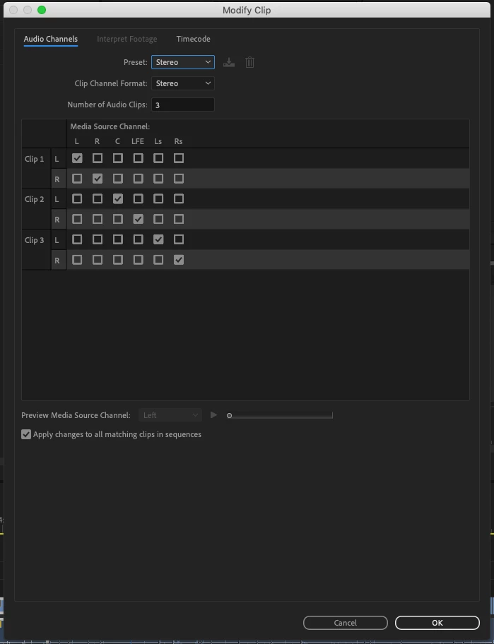

It looks like you've inserted the 2.0 (stereo) clip into a 5.1 (surround sound) sequence and it might not be playing all the Audio Tracks in your sound system. The healthiest thing is that you create a new sequence making sure that in the Track tab in the Mix option it is Stereo or Mono depending on your original clip and you reinsert your clip there. But if you already have an edit done, you can in the Project panel right click on the sequence / Modify / Audio Channels... in the Preset option you put Stereo or Mono. Make the necessary tests, see my screenshots.
Byron.

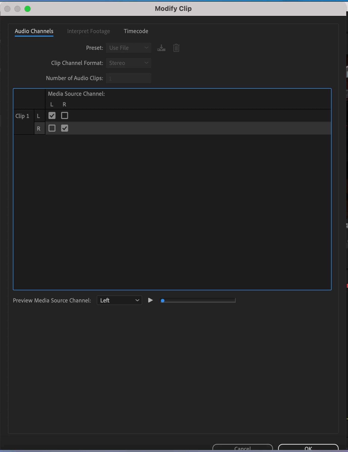

Check the configuration of the audio channels by right clicking on the clip / Audio Channels... It could be that you are not outputting on both channels, either in stereo or in mono the audio should be output by both. In this window you can adjust them.
Byron.
April 15, 2021
Is this what you're referring to?  Seems like it's got both...

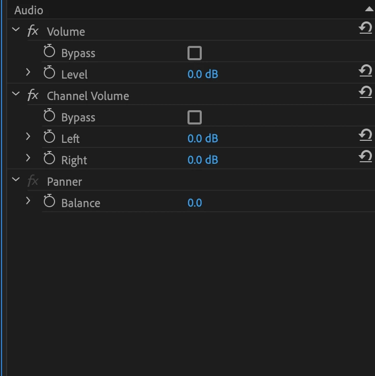

You can see there are no adjustments on the audio track in Premiere itself...
might there be something somewhere else affecting this?
