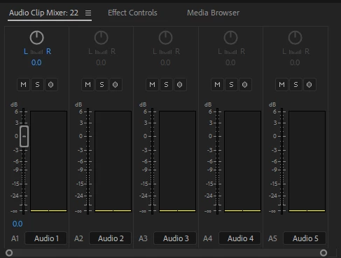

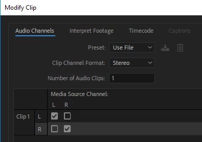

    Does Audio Track 1 have a small speaker symbol next to it?
    Is the audio stereo or dual mono?
    You can try going to the original clip in the Project Window > Right Click > Modfy... > Audio Channels > Preset > Mono > 2 channels.
    That may help the situation.

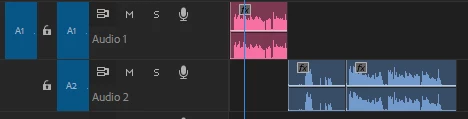

    this is my track situation Pics:
    red and cyan colors all are one clip audio. when I drag it to track 1 it turn to 1 channel ( in spite of that its waves shows two channel) but when I drag it to track 2 it back to stereo. I don't know what is wrong here.
    thanks in advance
    Meg The DogCorrect answer
    April 27, 2018
    Go to the menu Sequence > Add Tracks
    and add a Standard Audio Track and once that is done move the clip there.
    Is it now Stereo? If so use that track and delete the mono track.
    MtD
    Ann Bens
    April 27, 2018
    Please post screenshot of timeline.
