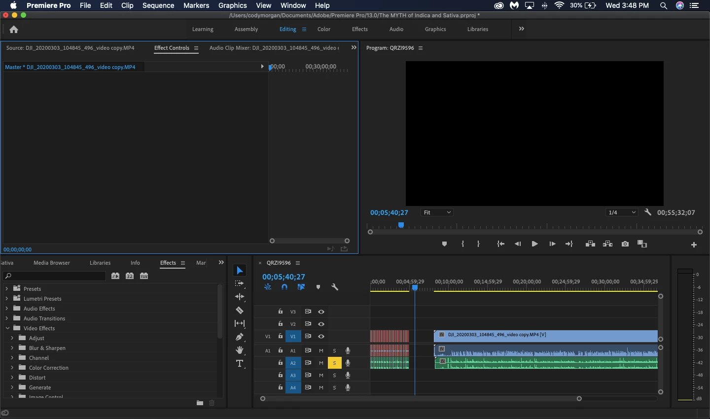

So I followed that article that you linked and for some reason, my layout is completely different. I can't seem to find the MPEG source settings that is talked about in the article. Here is what it looks like after I click on the effect controls:

iphone videos have a variable frame rate which can cause problems.  Use Handbrake to convert to a constant frame rate
https://handbrake.fr
Also, it's possible that your usb mic is causing some issues.  You may have to adjust either your speed of your video or the "tempo" of the audio without changing the pitch.  You can rough this out in premiere, but if you're adjusting the "tempo" of the audio, Audition will do a better job than Premiere.  You might run a test putting a clap at the beginning and the end of your recording.  If you need help with this workflow, post back, but hopefully handbrake will solve the problem.
