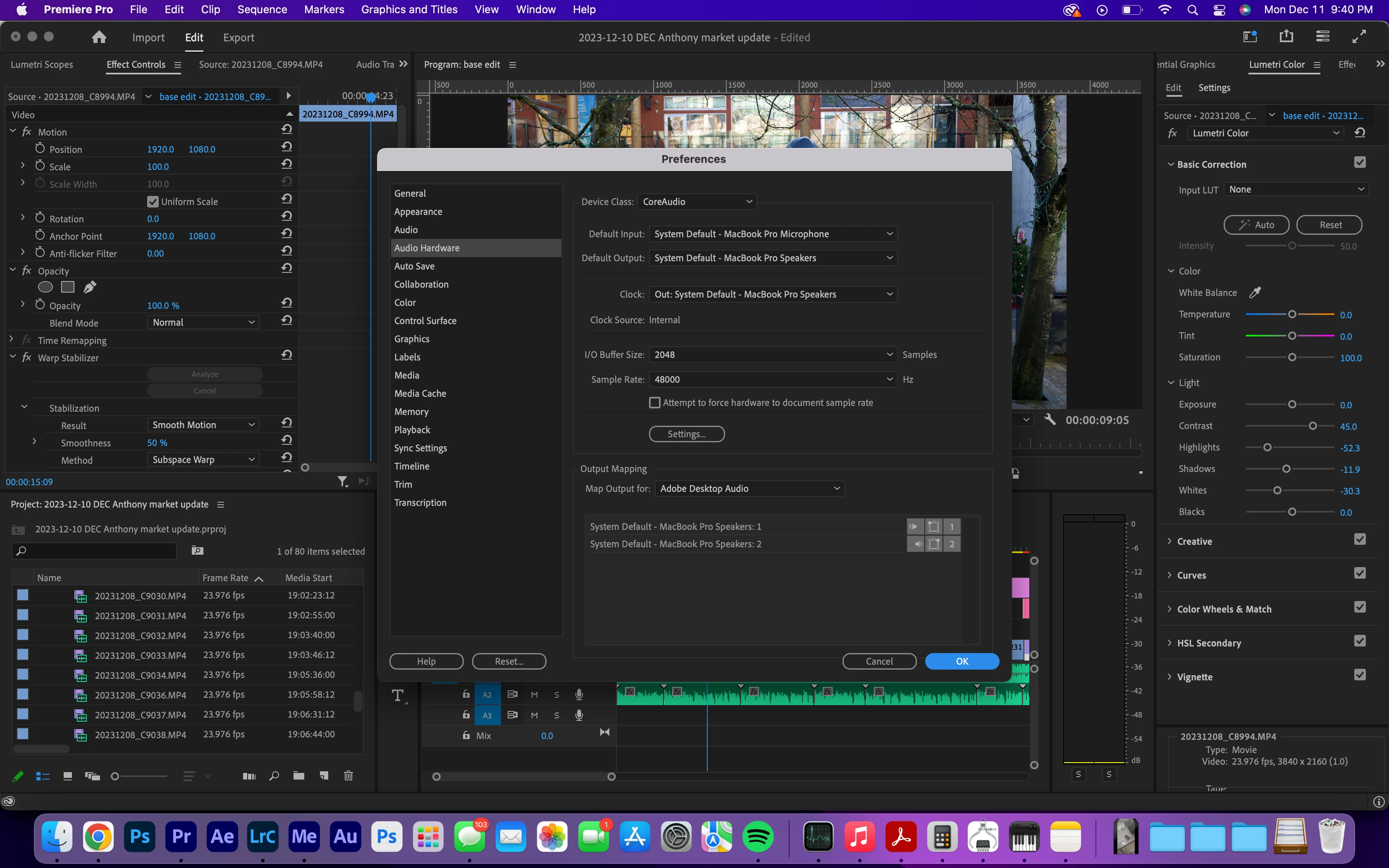

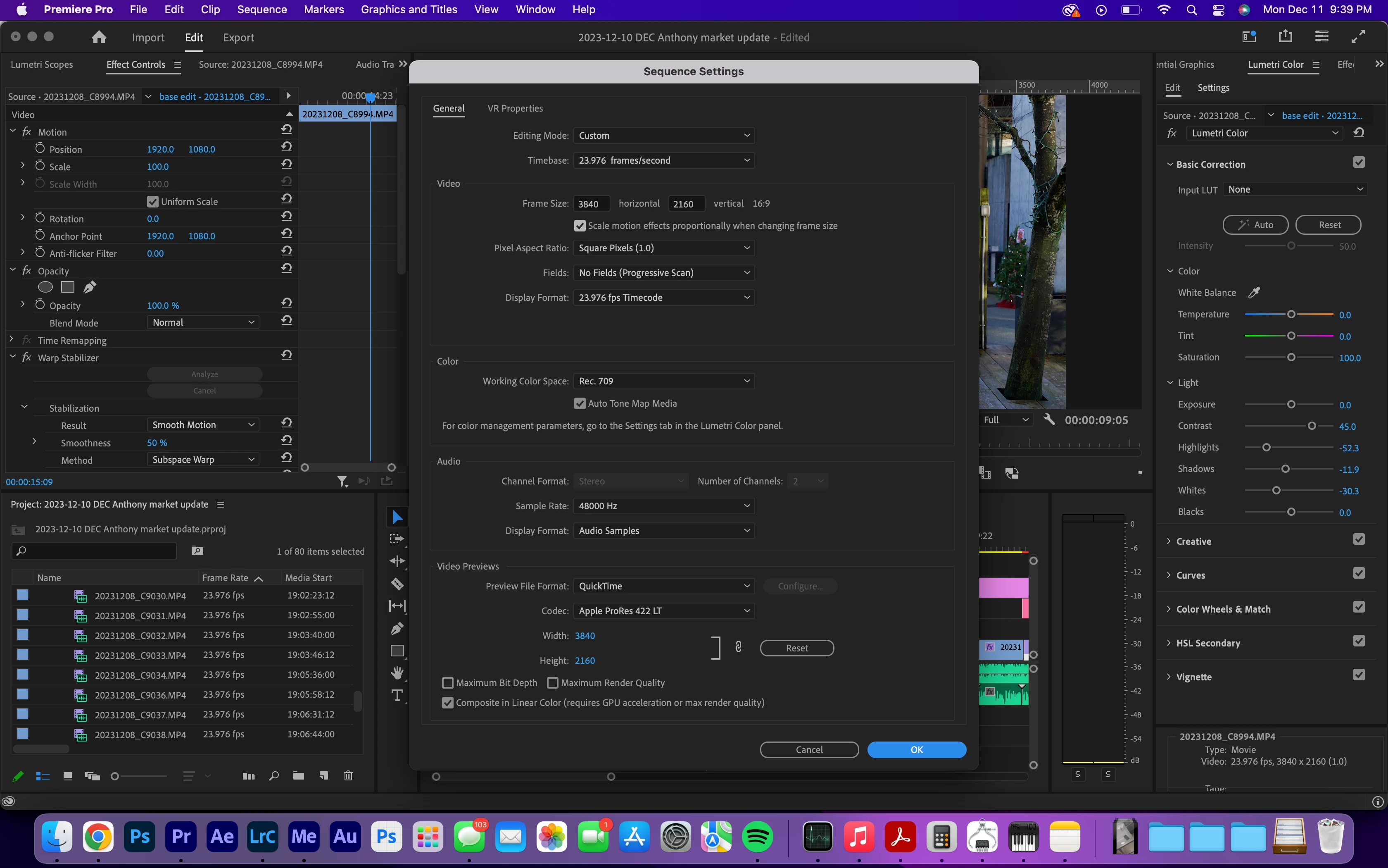

The raw clip off the sd card the auido is sycned perfectly with the person talking. Once pulled onto a timeline that matches the frame rates and hz sample of the clip its filmed in the words are two-three frames off.
Attached is my sequence settings and my auido preferences settings. Changing the i/o buffer to 2048 has mad it almost sync up, any lower value and the audio is lagging behind by alot.

thank you! Ive done that test i have made many sequences out of that audio clips and tried them out. i have also and changed i/o buffer to every number there is and it still is off slightly.

I would create a test project, import one clip, and drag to the new icon to create a sequence. Do you see the delay there?
I am partly wondering if the warp stabilizer could have any effect. It shouldn't. I'm assuming you don't have any time remapping.

December 13, 2023
does this help
Ann Bens
December 13, 2023
Did not expect otherwise.
Was more interested in the audio section.
Don't see anything out of the ordinary.

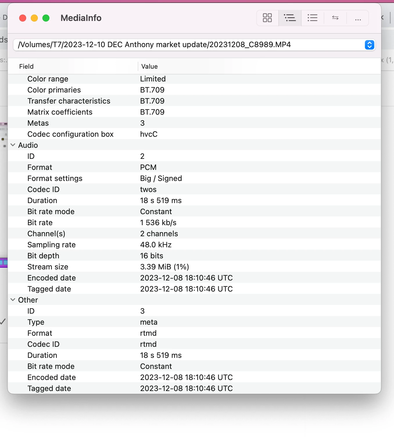

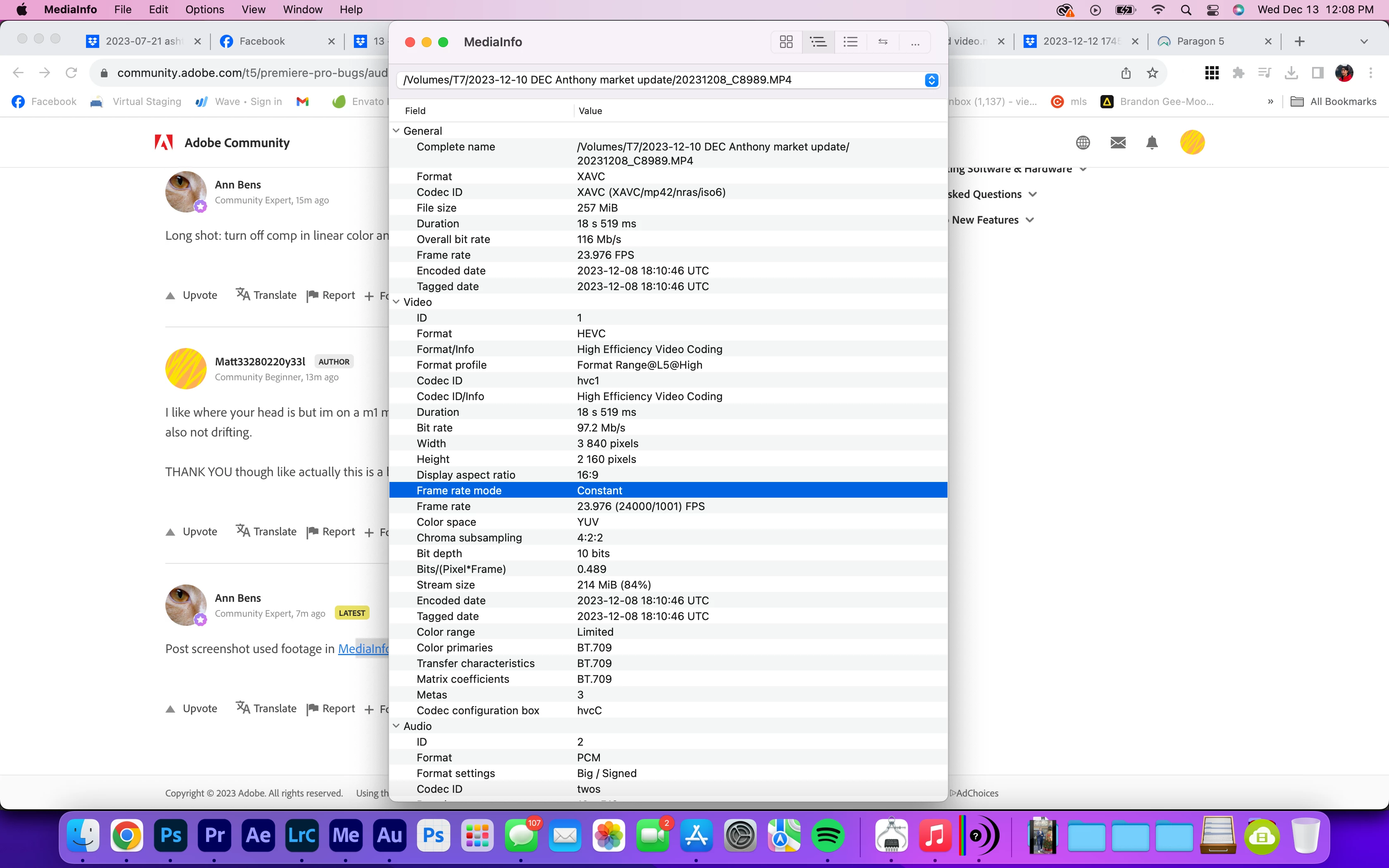

Post screenshot used footage in MediaInfo in treeview.
December 13, 2023
I like where your head is but im on a m1 macbook pro it doesnt lag. Its also the exported videos the words arent alinged and its also not drifting.
