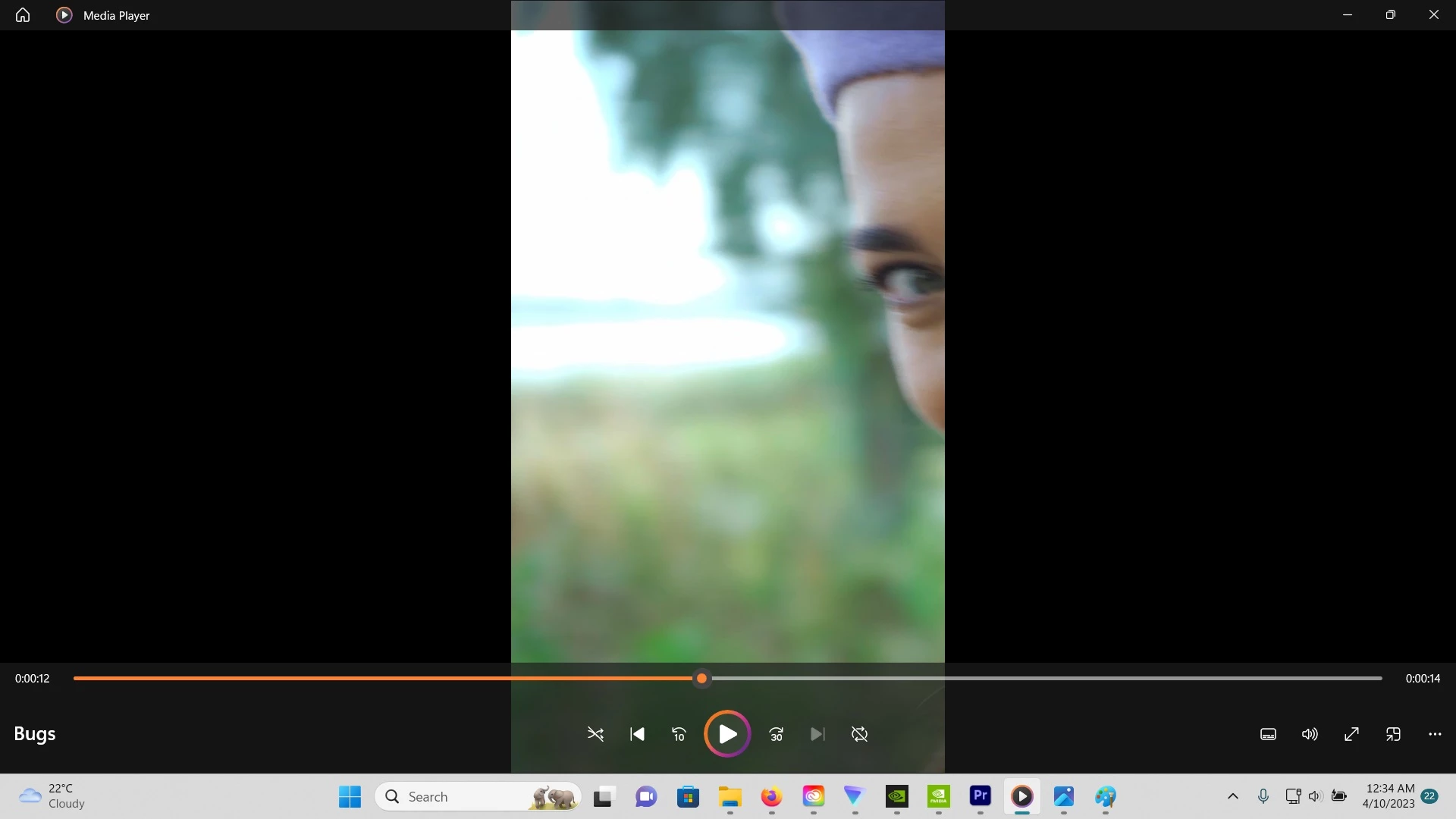

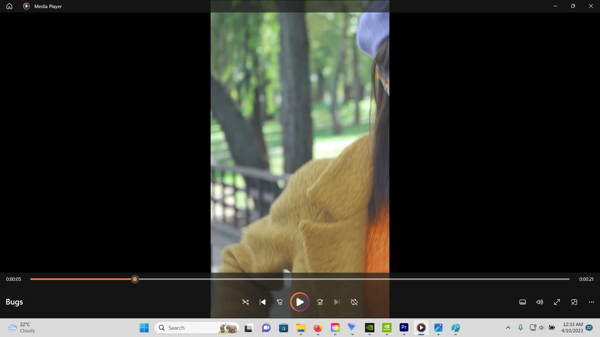

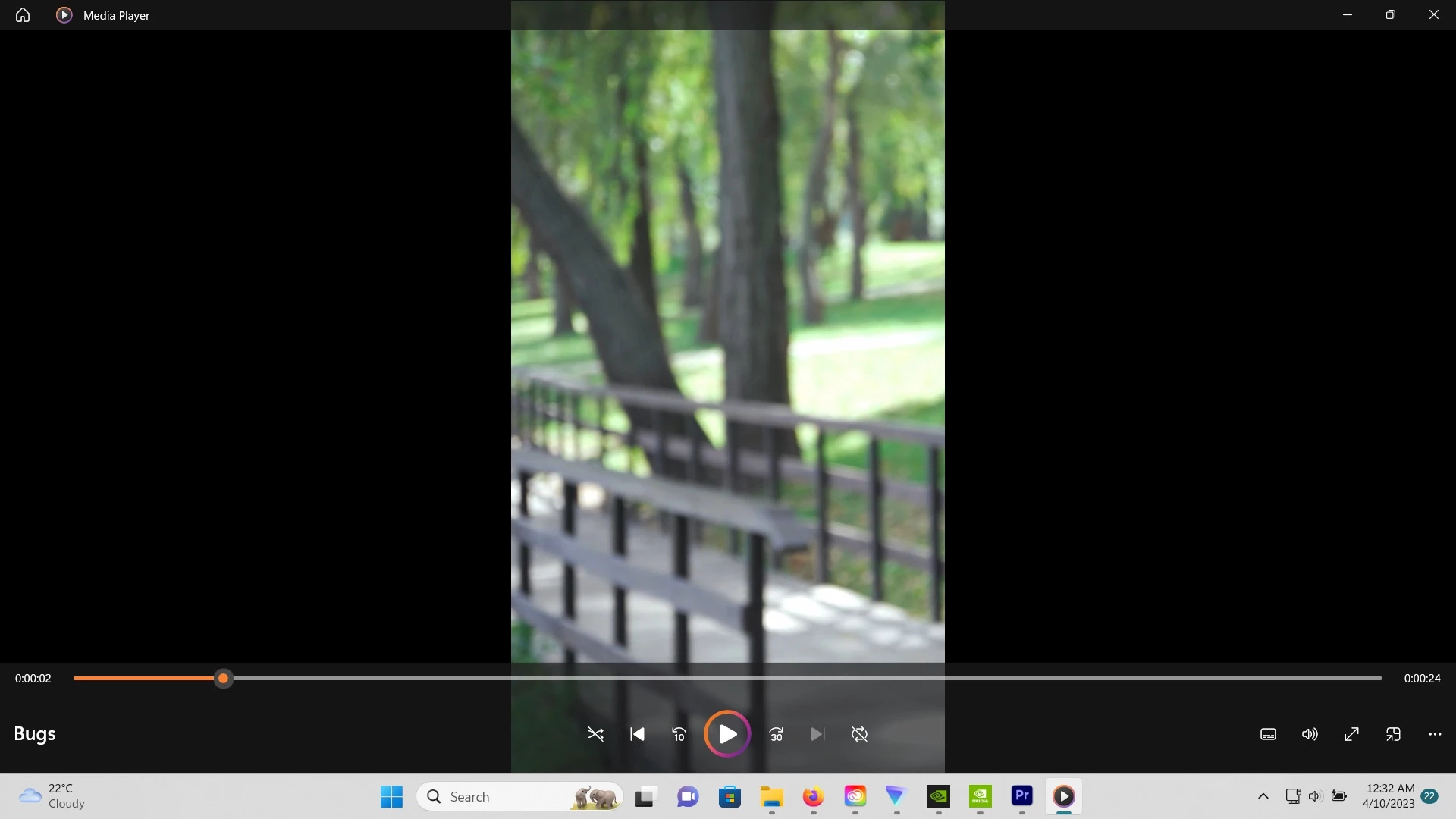

Apr 9, 2023 9:35 PM UTC
Here is how mine looks (by Auto reframe sequence)
Same even after getting the latest driver from Nvidia
Hope this will be sorted soon

Apr 9, 2023 8:54 PM UTC
I have the same issue, just that it looks even worse. I thought I was doing something wrong.
