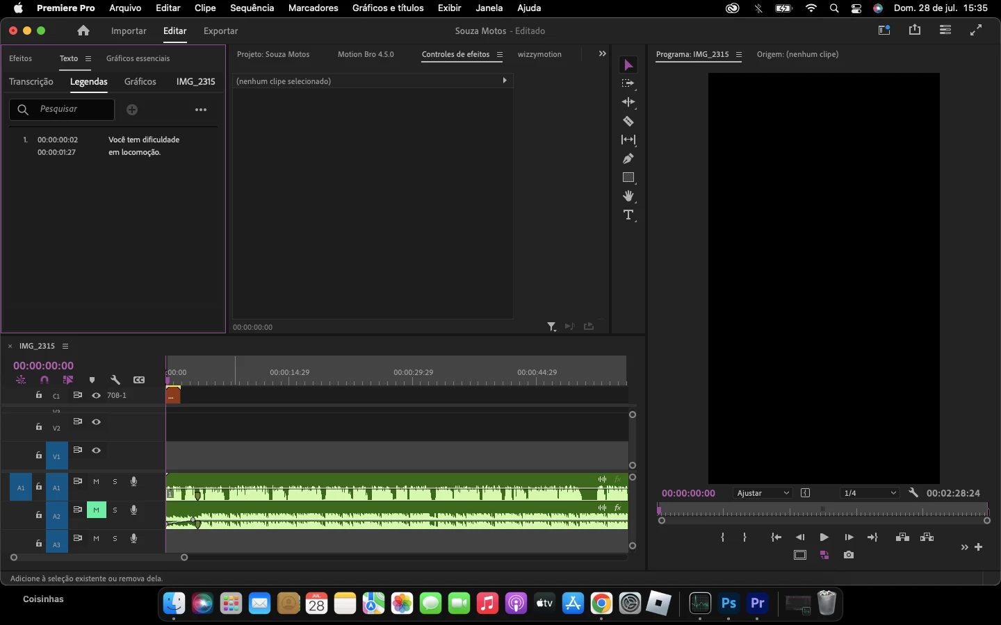

automatic subtitle is not completing
  • July 28, 2024
  • 752 views
When I use the "automatic subtitle" system it works but it simply isn't progressing with the subtitles, sometimes it only puts 3 texts or even just 1, please help me
Correct answer Alexander_DVA
Thank you for your feedback.
It looks like your audio source is using stereo input - if that from a stereo micorophone? If so can you please check if the transcription itself is also not showing all words or just the captions? If the transcription is incomplete too - double click the stereo track - click "..." in the text panel overflow menu - choose retranscribe and select one of the two stereo channels. It might be that your stereo input has a phase shift, which causes the two channels to mix down to silence - which could result in the transcript not "hearing" any words.

muitissimo obrigado alexander, você me ajudou demais
