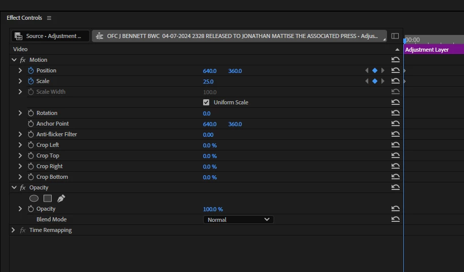

I have an adjustment layer that I want to change the motion parameters of it through automation blocks.  I want the position stay the same (640, 360) but have a keyframe at the beginning, scale set to 25 and have keyframe at the beginning as well.  Also is there a way to "uncheck" uniform scale?  Attached is an example from my user library that I want to add these keyframed motion parameters to, as well as what I am looking to for in the effects controls.
thanks

Hi Jeremy,
in the Automation Blocks library at
Examples/Clips/Keyframes/In and Out
you find the tools "Selected Clips - Fade In Out Opacity Subtle Scale" and "Selected Clips - Elastic Scale In Out".
They should get you started with inserting scale keyframes.
To check/uncheck uniform scale, you can use the Set Clip Parameter Value block to set the property
"Motion\Uniform Scale" to true or false.
