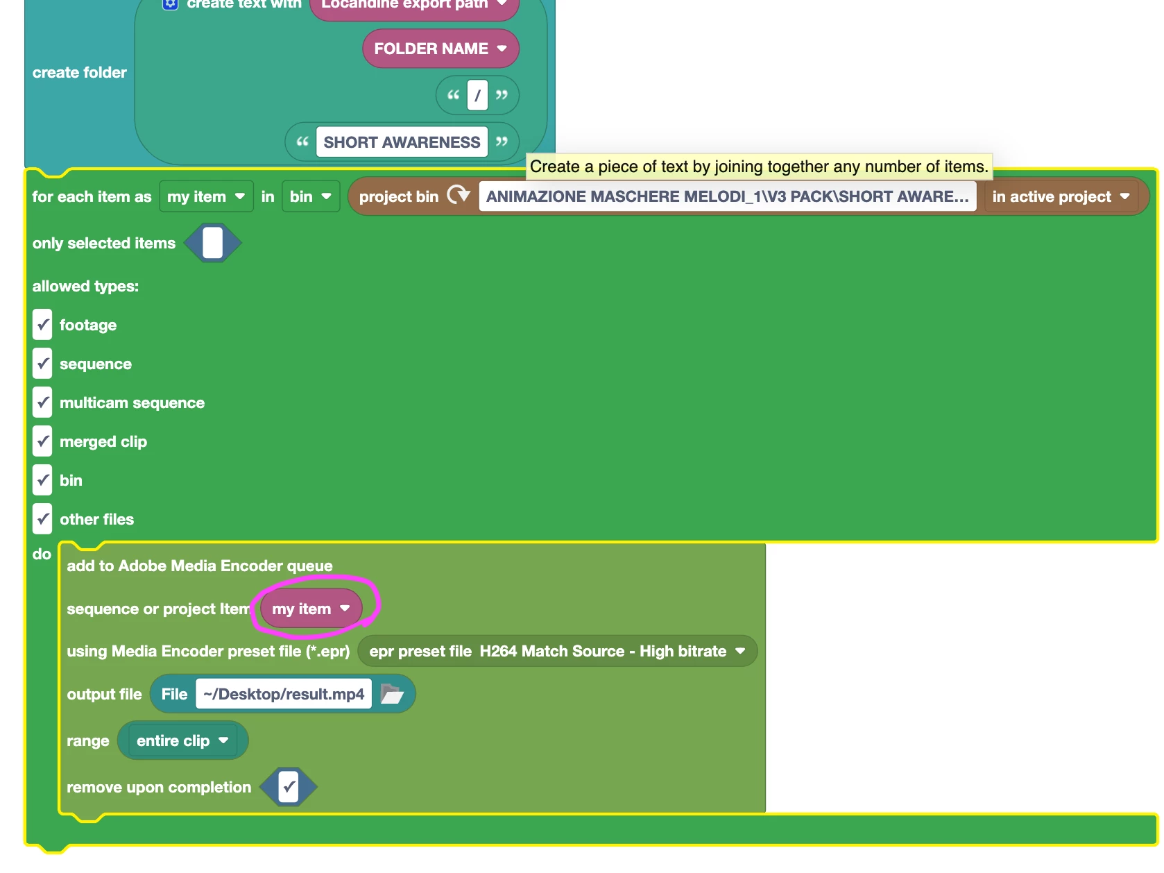

Hey guys, it seems i can't wrap my head around the ''for each project item" block.
From my understanding each item present in my premiere bin is saved temporarely in the ''my item'' variable.
When i add an ''add to media encoder'' block inside the ''for each project item", it works only with ''active sequence'' but not when i add the ''my item'' variable.
Am i missing something?
My objective is to export multiple sequences from one premiere bin in a predetermined folder.
It seems like it only works if i use elements from the ''Pr project item'' tab in Automation block.
I attached an image so you can see what am i talking about. I circled in pink the variable i think is the problem.
 Thank you so much for your attention.

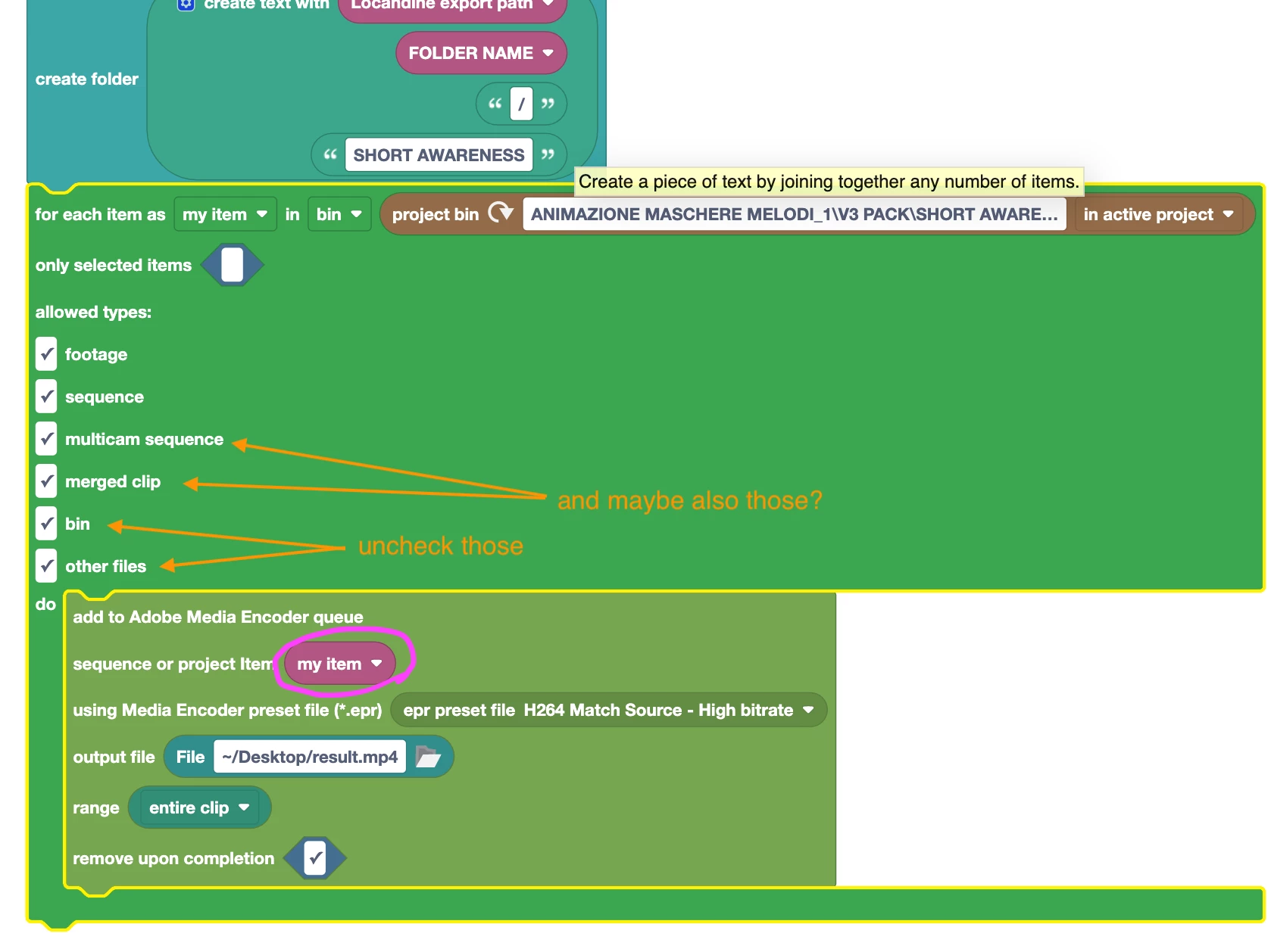

Hi @HAVAX,
you are correct that "my item" is temporarily replaced by each item in the chosen bin. In other words, in your code the "add to Adobe Media Encoder queue" block is executed many times - one time for each of the items - and each time "my item" is replaced by a different item in that folder.
I think the issue here is the filtering. The "for each item" block contains these checkboxes to decide, which items you actually want to process. Since you also checked "bins" and "other files", Automation Blocks will try to send any subbins or text files, for example, to Adobe Media Encoder, too. But since Media Encoder can only render footage and sequences, this will fail.
See attached screenshot:

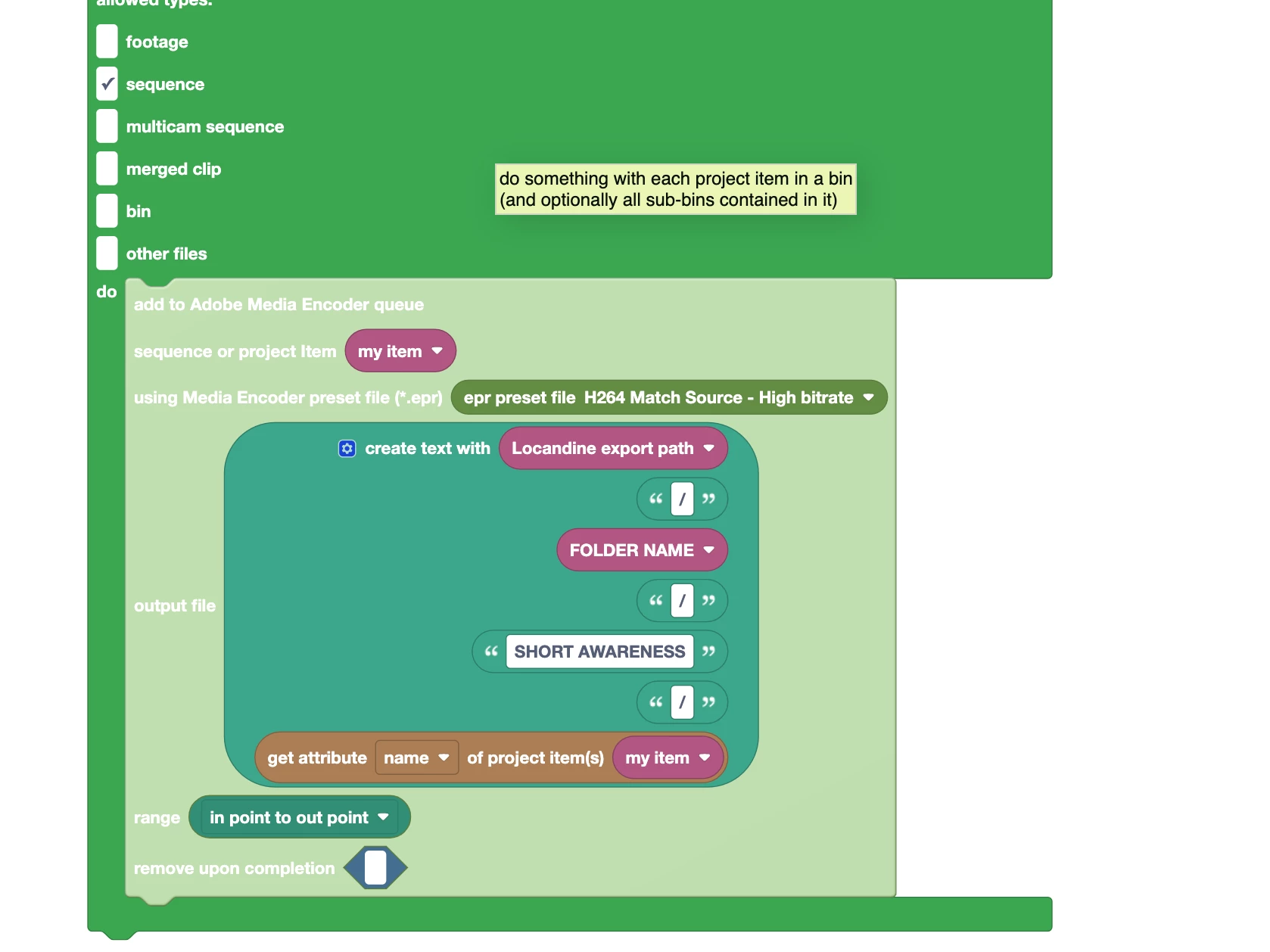

Hey i don't think that is the issue, i tested every single combination o those checkboxes and it still it is not executing properly.
 I also checked the console and it says this: ''execution result:"TypeError: null is not an object (line 6)'', still can't find the error...
Everything  else in the console seems right to me (filepath, export module, file name ecc)
Thank you for your reply 🙏
(I attached the color code i get for the blocks when i execute the script, maybe you can get some more info with that)
