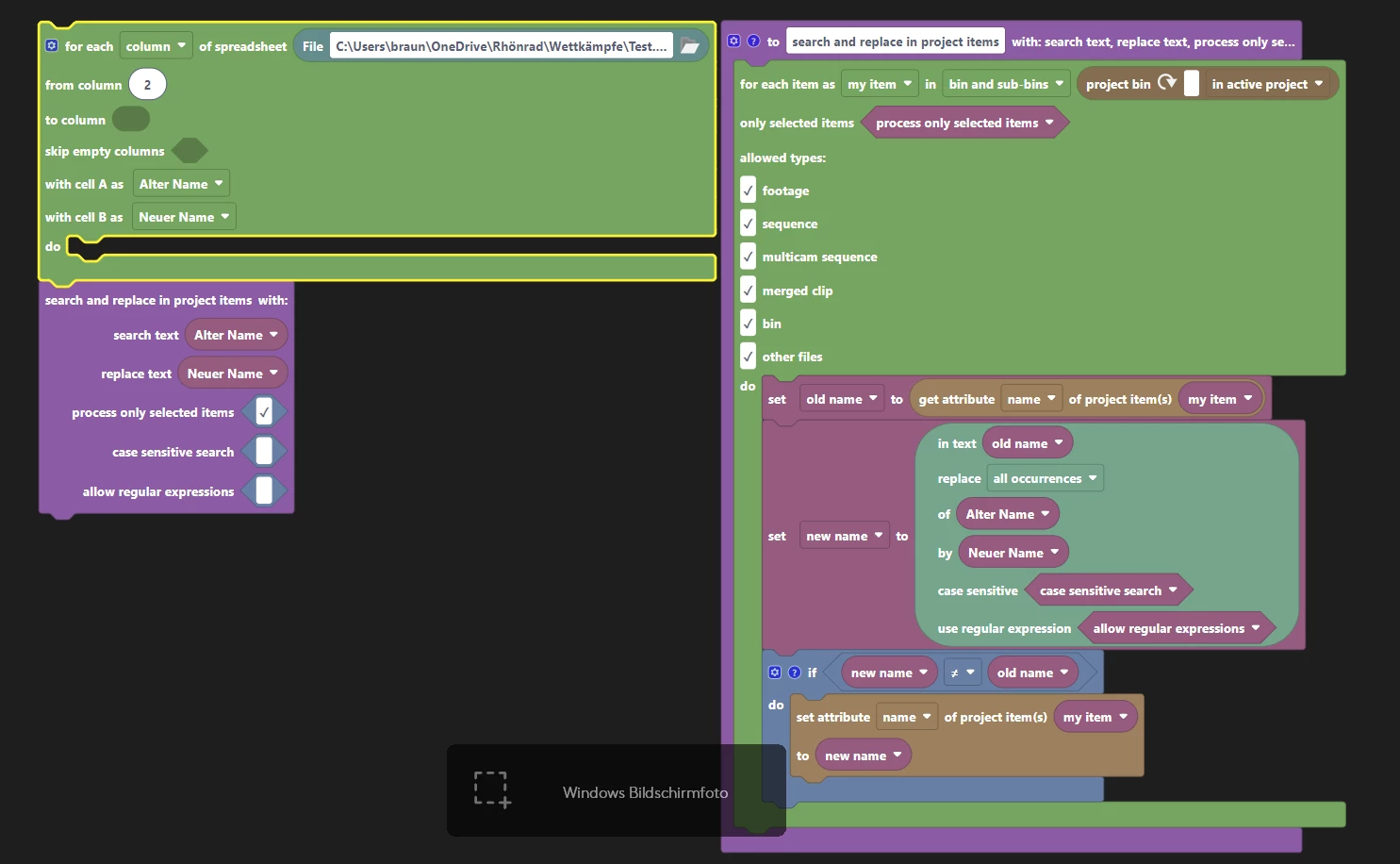

Automation Blocks Renaming multiple Timelines based on Excel.

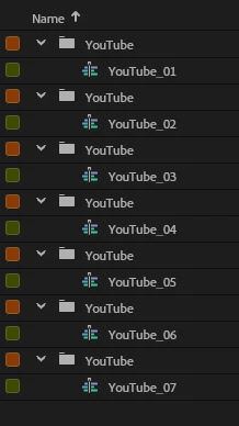

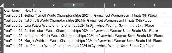

For a project, I regularly have to rename a lot of timelines based on a template from Excel. I used to do this manually, which takes a lot of time. Now I would like to automate this with the help of Automation Blocks. Unfortunately, I don't know what the appropriate script has to look like to realise this. Based on another script I have tried this so far as you can see on the screenshot. Unfortunately it does not work like this. What do I have to change to make it work?

OK. I have figured out where the problem was. The CSV file must be saved in CSV UTF-8 format (separated by separators). This is the only way the file can be read correctly.

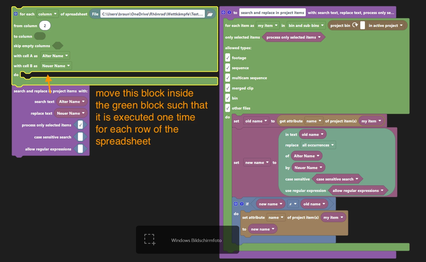

Looks almost good! Just plug the purple block inside the green one. Currently it is only executed once, after the spreadsheet has been read. If you plug it inside, it is executed many times, namely once for each row of the spreadsheet and this is what you want:
