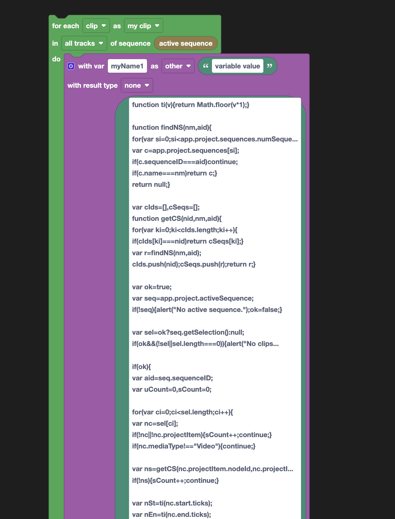

    lowdencraftww
    Mar 24, 2026 12:30 PM UTC
    The code below un-nests multicam trimmed sequences into elements stacked above the embedded source. But it does not respect the multicam source in point and seems to loop for each multicam source, therefore erasing what it has created. It also does not the end point either. But it does UN-NEST sequences in video tracks above the sources in the timeline.

    lowdencraftww
    Mar 24, 2026 12:41 PM UTC
    On the other hand, the method below works … and could be looped.
