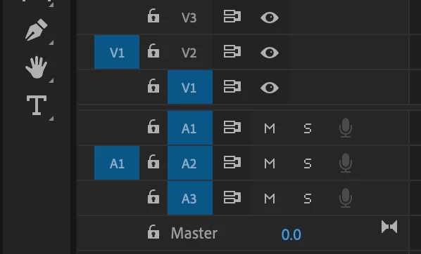

March 17, 2019
Not exactly sure how you are working with your clips but here's an idea for you.
Place your clip in your timeline on V1 and A1. Change your source patching to to V2 and A2. Next, in your timeline park your CTI or playhead where you want it hit your "O" key to set an out point, for instance this would be at the beginning of your clip. Now open your intro video clip in your source monitor (set in and out point if you need to) and hit your "." (period key) which is a short cut for an Overnight edit. This will place the end of your intro clip at the Outpoint you set in your timeline which should be right when your video clip starts. And because you changed your source patching to V2 and A2 your video and audio will land on different tracks and not overwrite anything on your V1 and A1 tracks.
Here's a screenshot of what the source patching should look like.
If you don't change your source patching and just work on your V1 and A1 tracks hitting the "," Comma Key will insert your video at your CTI. But if there is space between your clip to the right of your CTI it will keep that space. And if you CTI is parked in between the start and end of you video clip it will split that clip and insert your video in the middle.
So lots of ways you can tackle that problem. It all depends on how you want to work.
