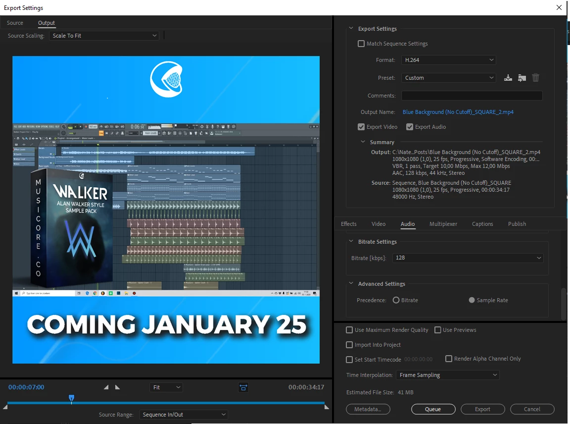

Why is sample rate selected in your Export settings? Is that an Adobe default? Have you adjusted/multiplied the levels in PPro? Are the levels in the audio meter not going in the red? If so, please adjust them in the audio track mixer so they don't go beyond 0 dB (which is clipping).
January 17, 2020
This video has to be uploaded to Instagram, so I have to export it as 128 kbps otherwise it will sound bad on Instagram.
The meter is peaking at -3 dB.

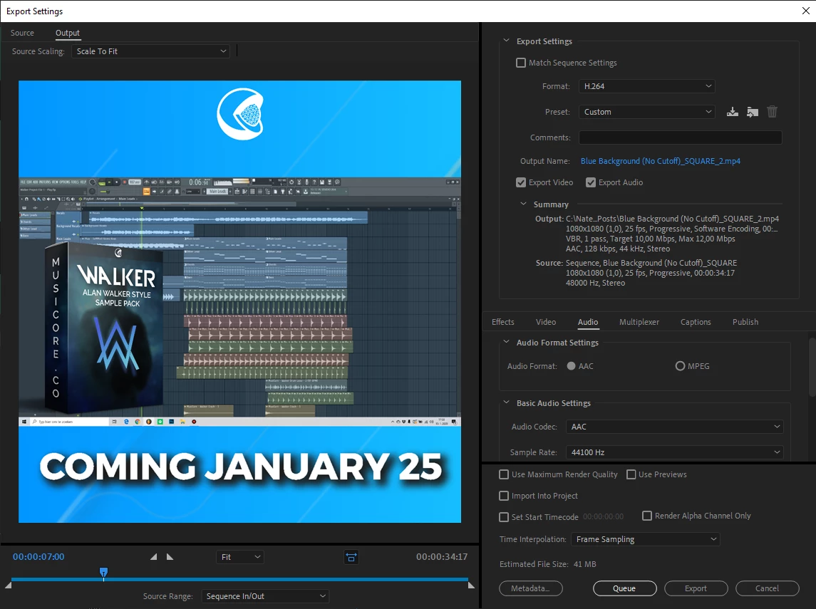

I am working with 128 kbps mp3 files (the video will be posted on instagram) and mp4 files. The resolution of my video is 1080x1080
My Export Settings
January 16, 2020
mp3 files are already extremely compressed.  If you can't get better quality sources, you might try converting them to 48k 16 aiff and see if they sound ok and if so, do a test export...
