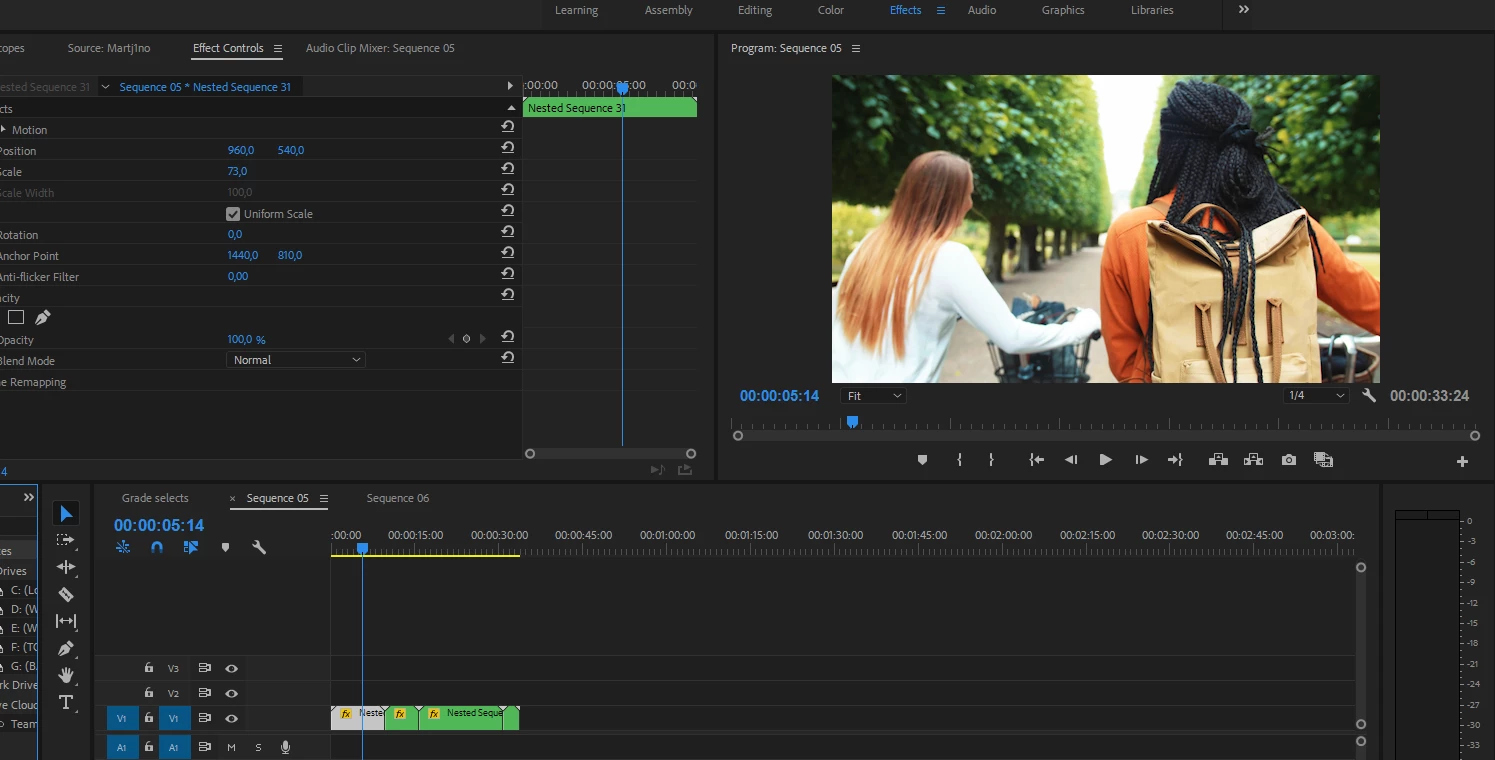

The project where i nested each clip after grading and applying effect. How can it NOT read the color information :S

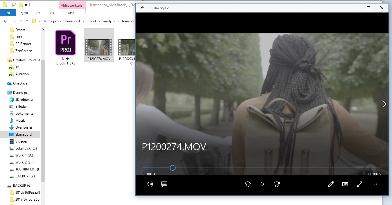

The Result, nice file but no Lut og effect exported :S
