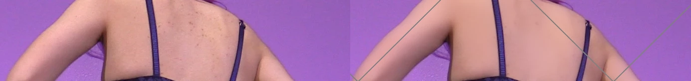

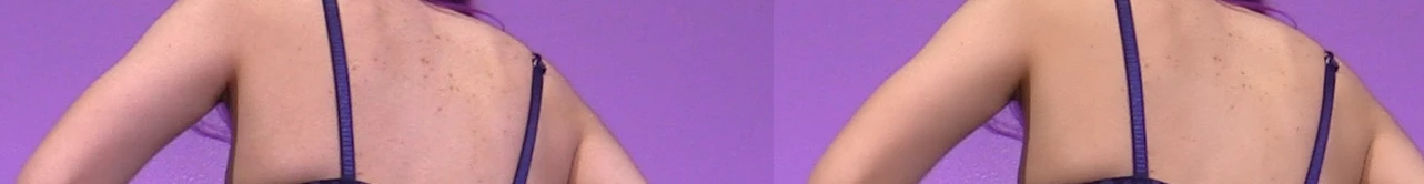

So far I'm finding Beauty Box easier but I have only spent an hour messing with each one.
Cosmo looks crisper but Beauty Box covers marks much better.
Befores on the left.
Cosmo:
Beautybox:
