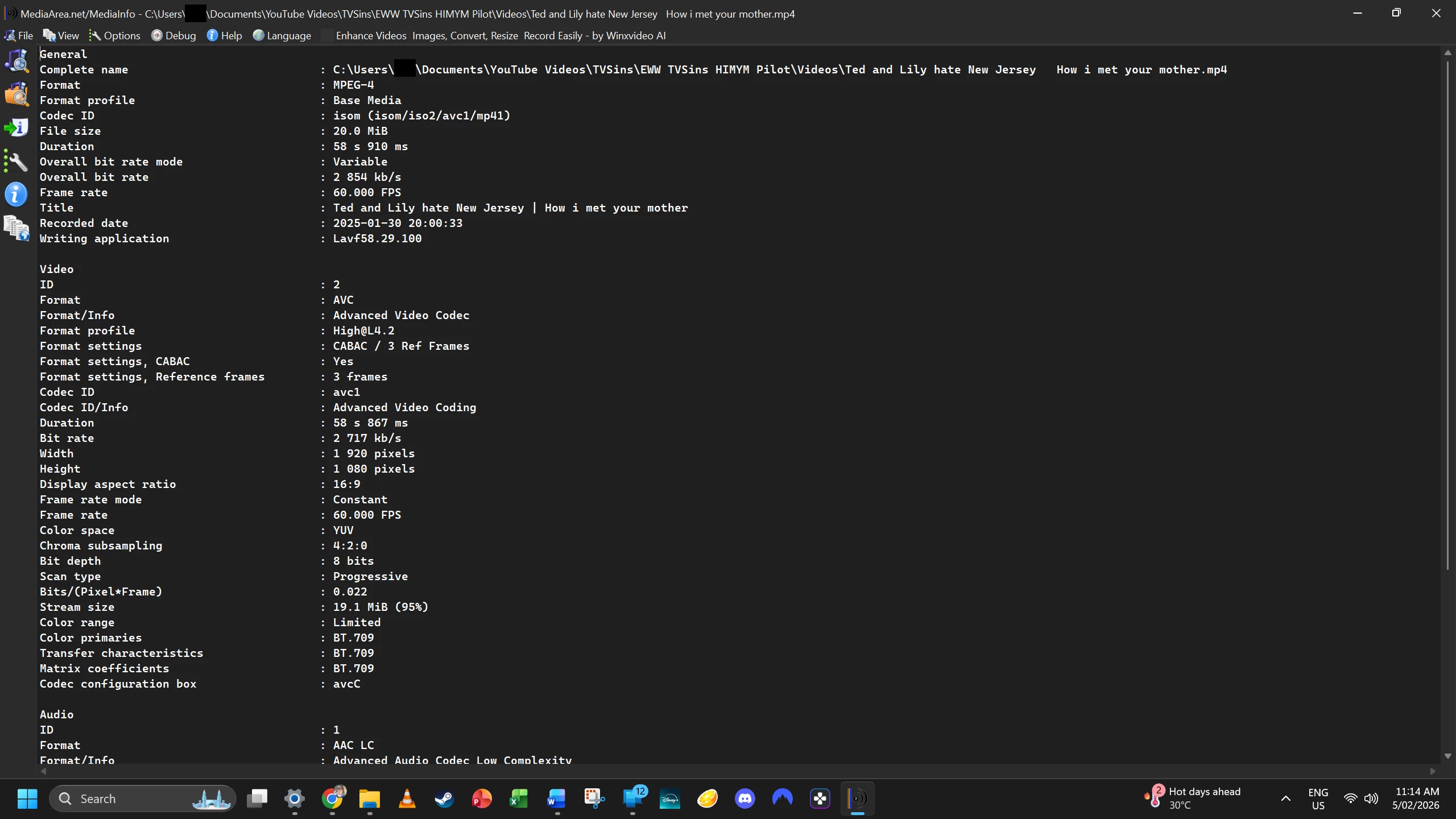

    It appears the clip was originally 29.97 fps, then converted to 60 fps by duplicating frames, not in a clean 2:1 cadence. When you place that 60 fps file into a 23.976 fps sequence, Premiere must drop frames again, and not in an even ratio. That repeated frame duplication and removal is what causes the uneven motion.

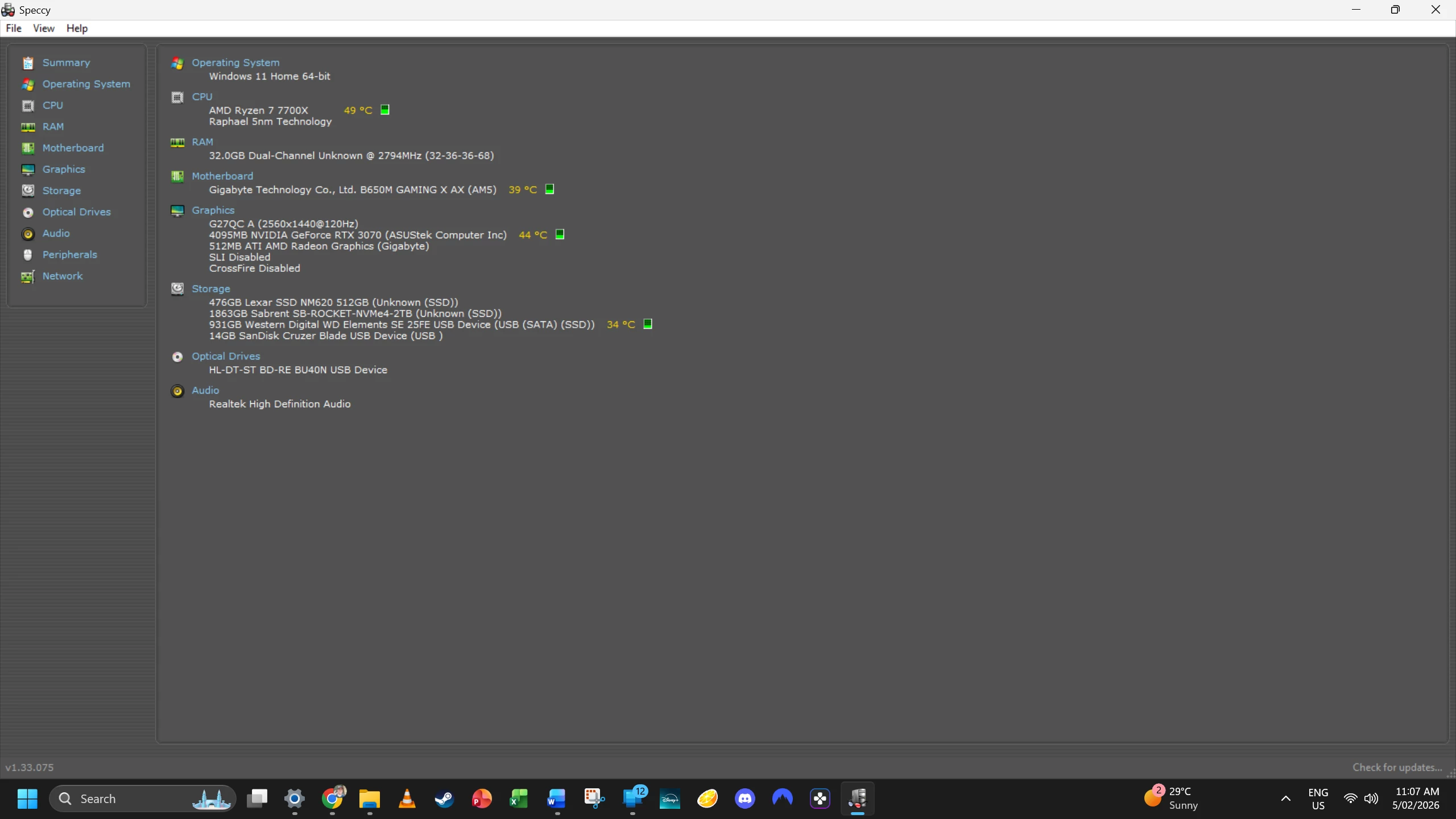

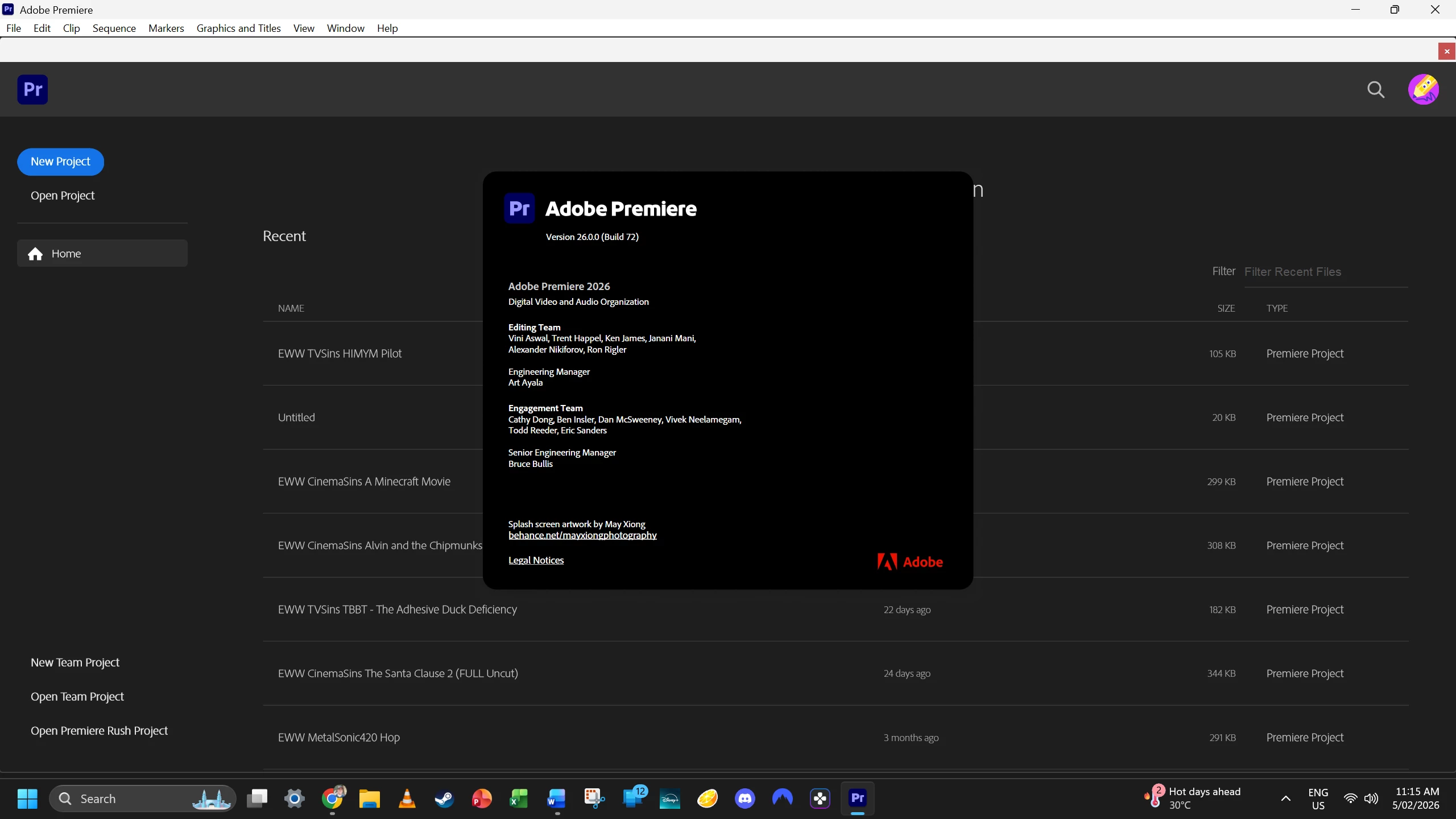

     Forgot to add my PC specs, file info and Premiere version, so I’ll attach screenshots here instead :)
