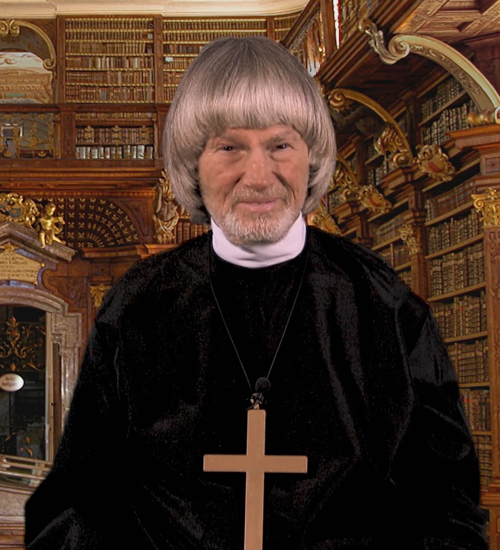

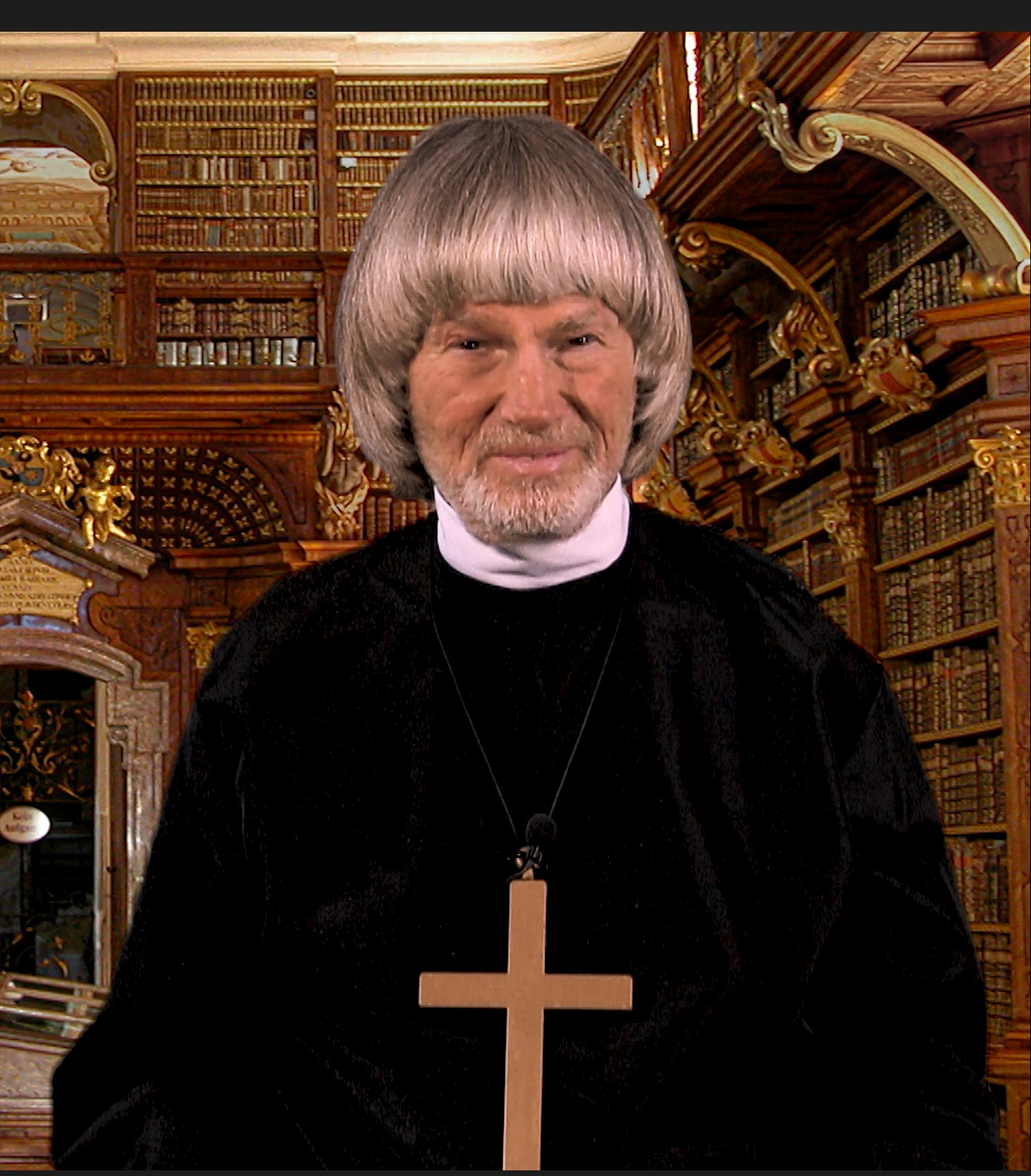

Best mp4 player? VLC looks very different than playing within Premiere
While this post shows VLC and Premiere looking almost exactly the same, my VLC looks washed out compared to Premiere. I am going to show this in theaters. They may not have the DCP, just a video projector which plays mp4, perhaps some other formats. Which is the best mp4 player? I have a DCP player on my other computer. What should I do?
VLC
Premiere Pro PlayerPost showing Premiere and VLC the same

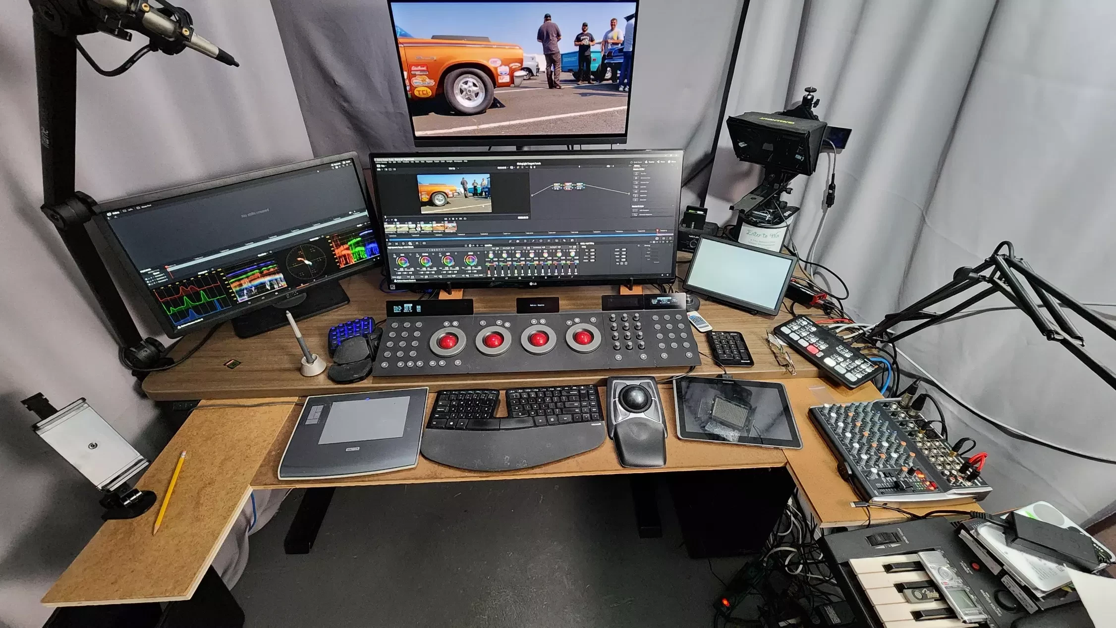

    My humble setup …  as I do a fair amount of tutorials, advising & conusulting, including working on difficult grading issues for various & sundry persons, plus software and hardware testing mostly on NDA status … but I do not do any broadcast or theatrical release work myself.
    Note the camera on me and the Tangent Elements panel …  front left to right, Wacom pen tab ( I’m a lefty), keyboard, Trackball, and an older tablet used for the Tangent “verisimilitude” mode; then a gamer’s button box I’ve actually just removed from use, the Elements panel, BM switcher … the monitors an ultrawide ‘main’, standard Dell on left for second panel and sometimes scopes, Reference monitor up top, and a small monitor for scopes primaraily lower right.
    The Ref monitor is of course calibrated and then profiled … meaning another pass with specialized software that checks the screen outputs when fed specific inputs, and gives a series of charts and data on the actual result of the input. Until those charts and data are within tight specs, you … redo. And with the upcoming move, I’ll naturally have to fully run that again. Oof.
    This was the supposedly “temp” setup, from a move a couple years ago, that I expected to be in use only a few months. I will finally be moving into my own full room again next month, though I hate moving. I’ve somewhere over 25 USB devices/connections at this time, and they are all setup to run without conflicts … but I can never unplug and carefully re-establish without having to move something from one hub to another to resolve conflicts.
    It’s all on a standing desk that I added the front shelf for the keyboard to … so that I can have it at the best height for keyboard, or drop an inch or so, and have best height for the panel.
    In normal operation it’s rather dark, there’s 18” between the back of the Reference monitor and the gray curtain, and there's a bias light on the back of that monitor from MediaLight (biaslighting.com) set to a precise brightness according to the specs for Rec.709 workflows.
