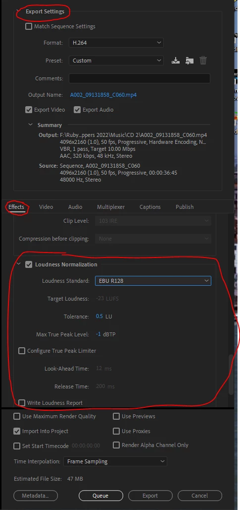

October 8, 2021
Not quite the same thing but you do have loudness options on the export menu.
