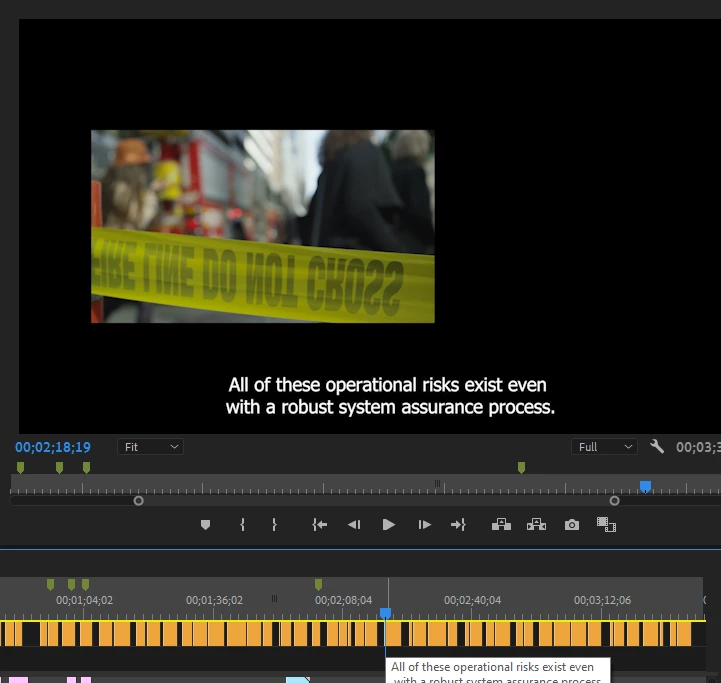

This seems to be a common question and I'm very new to adobe premiere and somewhat confused on how to resolve the issue.  When I see the preview of my video, I see black bars on the side, although I had scaled all footage I used to avoid this while creating the video.
What resources can I use to to learn more about video sizes and how to avoid this?
Is there a simple fix for this problem?

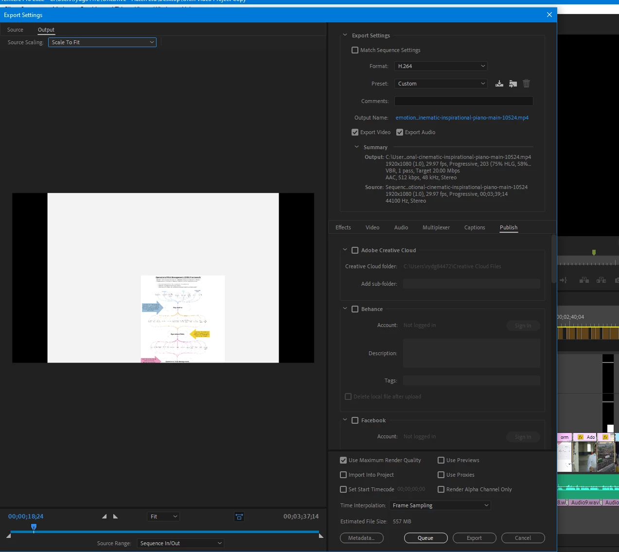

First screen shot shows the black bars in preview. If i changed it to scale to fill... then I lose text on the bottom from where I have different phrases come up alligned with audio..

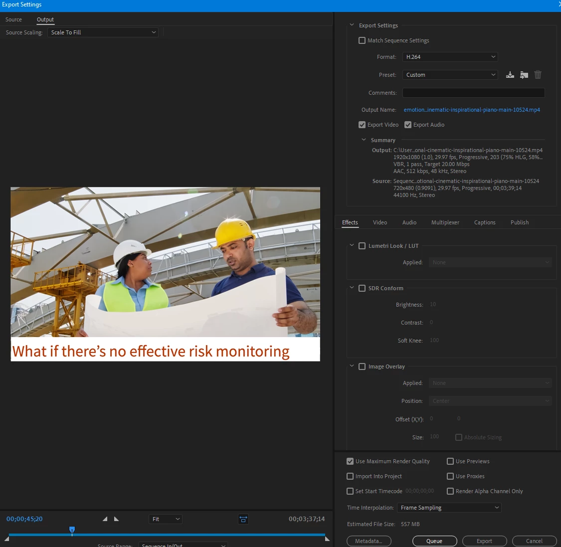

You are editing your footage in a 4:3 SD sequence with a resolution of 720x480 and are exporting to HD at 16:9 with a resolution of 1920x1080. Ths gives black bars and bad video quality output.
So, are your source video 720x480?
If the source video is 1920x1080, go to Sequence > Sequence Settings and set the Editing Mode to Custom and change the Width to 1920, change the height to 1080, change the Pixel Aspect Ratio to 1.0.

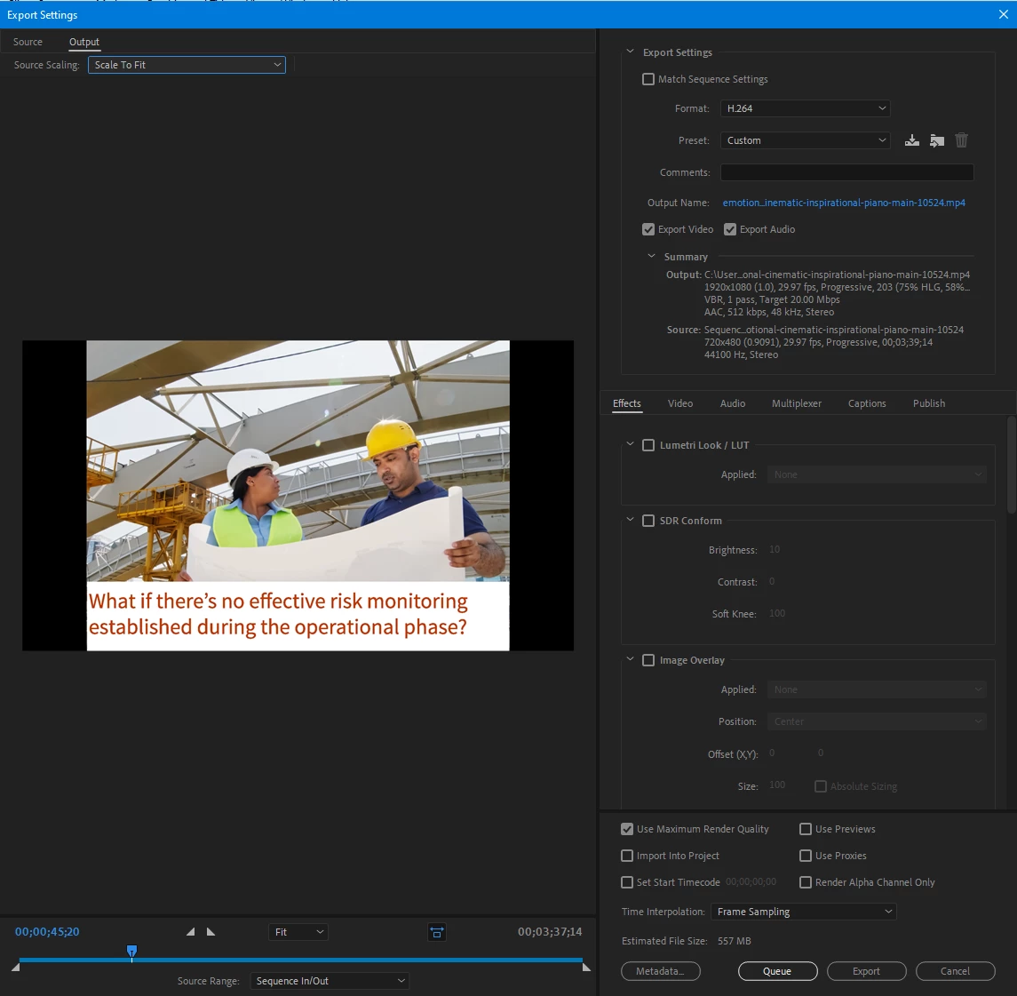

Thank you so much for the advice. I made that change and now all the clips I have in my video... are completely incorrect in sizing and position, does this resolve when you export or does everything have to be edited and scaled again?
January 20, 2022
another screenshot attached
