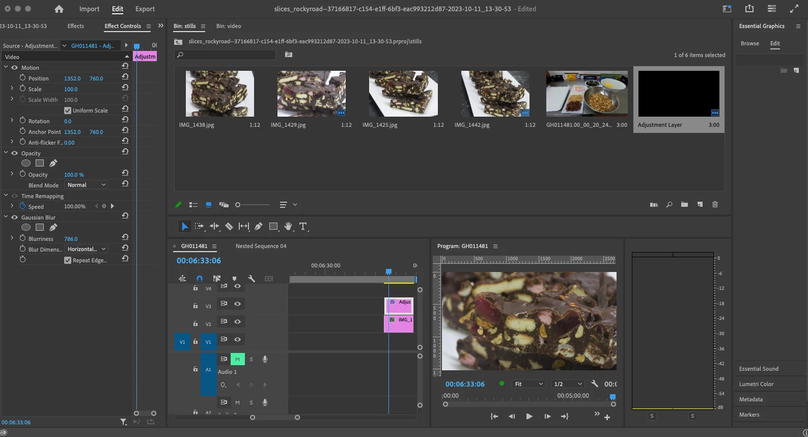

Blur not working at all
has to be something simple. I have my adjustment layer above my image. Dragged blur onto the adjustment layer. attempting to blur but nothing is going on in the screen.  Appreciate any help.

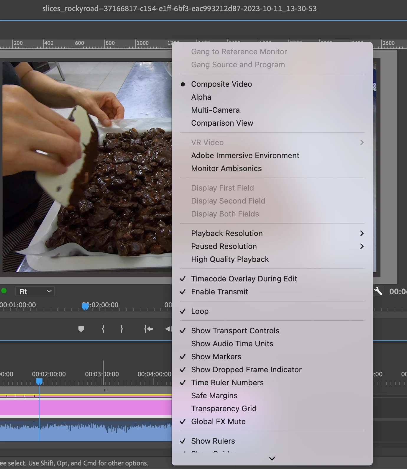

Is is possible that you're turned on the "Global FX Mute" by mistake? It's the little "fx" icon under the program monitor.

bang on. Thank you. Global Fx mute was selected.
