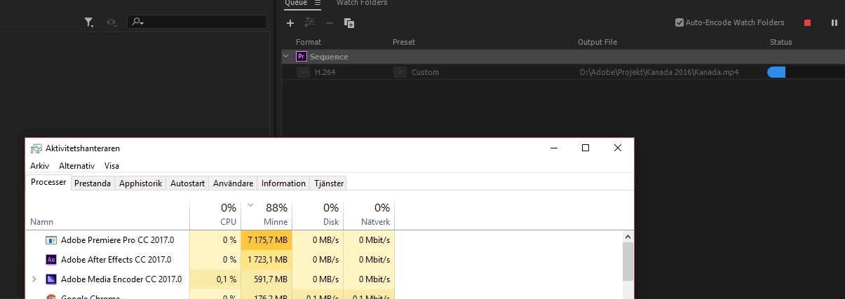

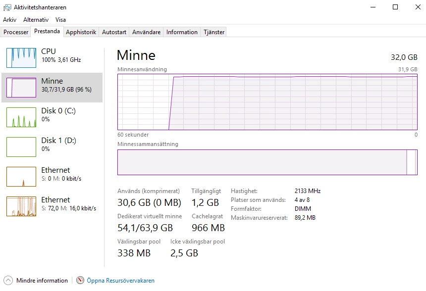

I'm not sure but I think its a memory issue with Adobe during encoding. I have set in the settings that it should leave 10GB of memory to other applications, ie 22GB available to Premiere Pro. Checking in Media Encoder gives the same value. It is also set to memory mode instead of performance.
Looking at the Activity Monitor during encoding it looks like Adobe is using way more than its allowed 22GB. Correct me if I'm wrong but I read it as Windows has 64GB of virtual memory, 32GB physical and 32GB system page file. When I took these screenshots before going to bed it seems to me that almost all of the virtual 64GB memory is used, 54.1 of 63.9? And when I got up this morning the computer had crashed and restarted. Checking created mini dump showed the NO_PAGES_AVAILABLE bug check string.

The four 8gb memory sticks designed to run at 3200mhz was running at 2133mhz, ie XMP was disabled in bios. So I enabled XMP profile and memory sticks changed to 3200 like specification say.
