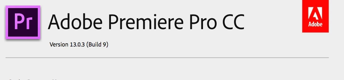

You're using the current version 13.0.3?
yvesmagatAuthor
Apr 2, 2019 12:49 PM UTC
Yes 13.0.03. ( and paid...)
I still have on my Mac and old demonstration version I don't use any more (CC 2017). Could it interfere ?
