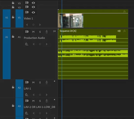

Problem: Every time I export an AAF no matter if I flatten it, I get a stereo output from the track I have labeled as "Production Audio." This houses lav, boom, etc. I seem to have the 12 channels in the multicam configured properly(Mono 12 channels and panned correctly) and have an adaptive channel if my main timeline where the mono tracks are assigned to the respective channel in the adaptive track I have labeled "Production Audio."
What I want to do is be able to edit multicam sequences with multiple tracks of audio in one track in the main timeline and if I need to jump in and mess with any of the levels I can punch into the multicam clip and see all of the audio. By the way, I can already do all of this, but unfotunately I can't use this workflow until I figure out how to prep it for the AAF at the end of the project. If anyone has any experience doing this, please advise.

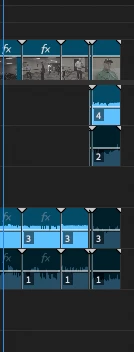

Below, the green is the multicam seq in the main timeline and the blue is the synced multicam clip.

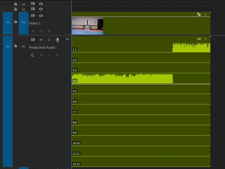

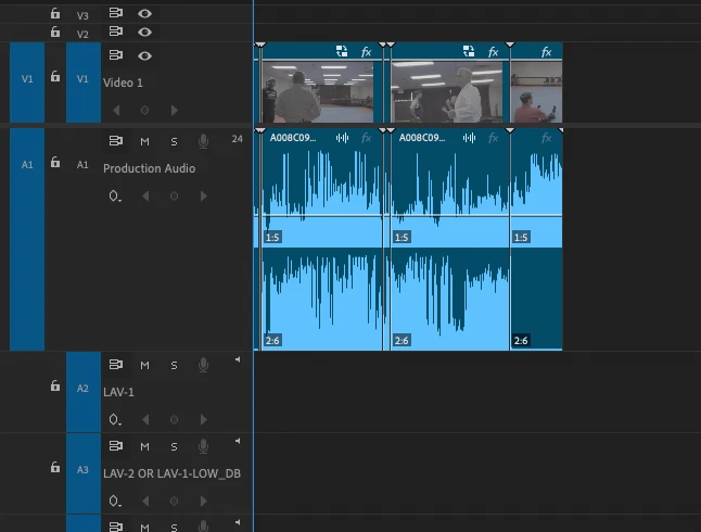

If I bring in the same multicam clip in as a sequence(with the same Adpative Clip Channel format via sequence settings) into the main sequence I am working in, it will show me the audio laid out correctly. I can even export the aaf and it will break out the mono tracks correctly labeling them Production Audio_1 - 12 which I can live with. However, with multicam it's a different story. Please scroll down.
If I enable that sequence as multicam and then flatten it, the audio it deems is attached to a given camera will appear. Below is Cam 1.

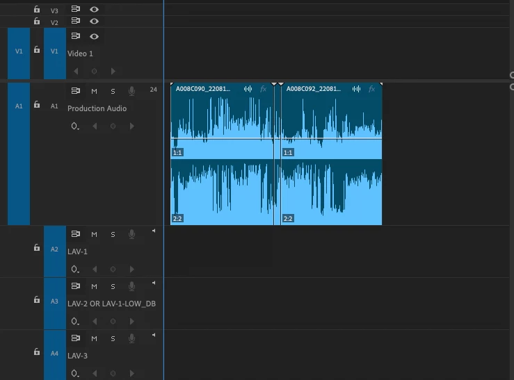

And if switch to CAM 2 and flatten, I get this.
Down the line, we are going to have interview with multiple angles and for me personally, I think it would be much more tidy to be able to keep all of the production tracks (LAV, BOOM, CAM Audio) nested in it's own multicam. That is ALMOST achievable here, but not quite. Unless there is a workaround that I am unaware of?
Jan 19, 2025 2:59 AM UTC
You are correct that when flattening an adaptive multicam source sequence made up of multiple audio sources, Premiere Pro cannot recreate the same layout because it does not allow more than one clip to exist on the same track simultaneously.
That said, is there a specific reason why you need to flatten the multicam sequence at some stage? If you're exporting an AAF for something like ProTools, you should be able to keep the multicam sequences intact. This approach will help preserve the organization of your production audio (LAV, BOOM, CAM Audio) without the need to flatten.
