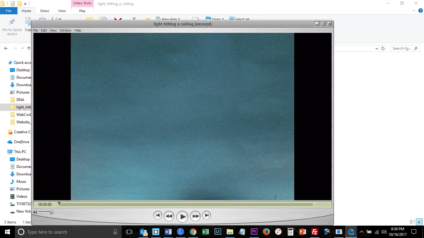

    Post a frame grab.
    Should be easy enough...and even easier in After Effects

    Thanks for your reply.  It's in the bottom right corner.
    October 17, 2017
    After Effects has the same Clone Stamp tool from Photoshop.  That should do the trick for a static shot.
