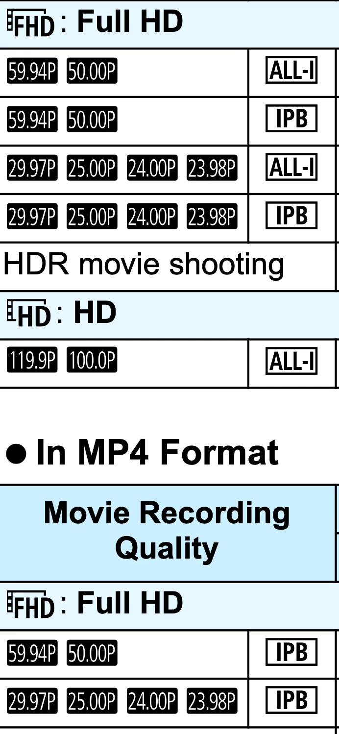

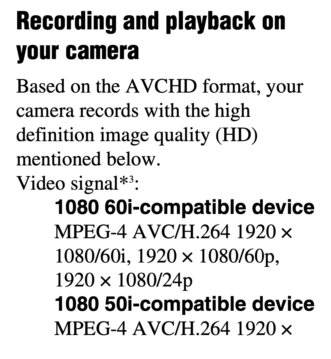

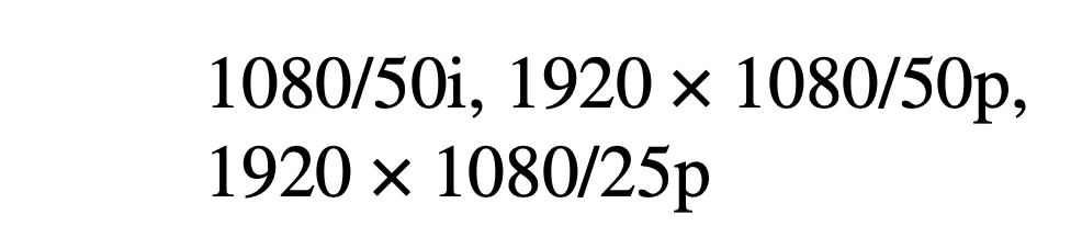

You should be able to import and work with both formats fine.
July 23, 2020
of course you can, but should you?  staying with the same frame rate will make the op's life simpler...
July 23, 2020
Make sure you use the same framerate for both cameras.
Ann Bens
July 23, 2020
Or at least co called PAL or NTSC

Here are screen shots from the manuals of each...trying to figure which is the most  compatible mutual setting  for each.
Canon 5D M4:
Sony 65 alpha:
