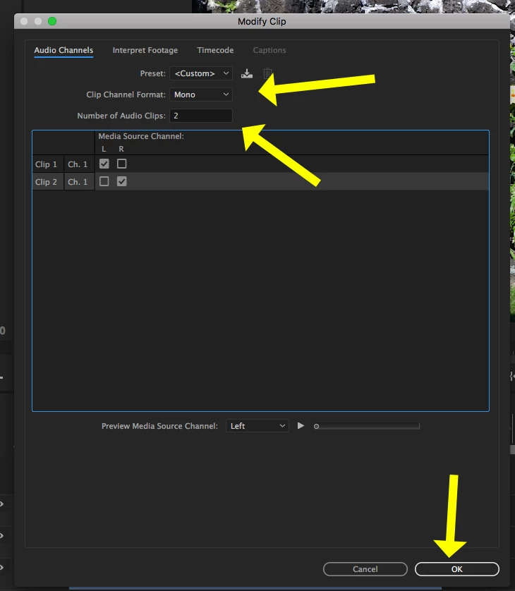

    Click on the camera source clip in the Project Panel to select it. Once it is selected, right click on it and from the drop down menu choose Modify > Audio Channels.
    When the Modify Clip pane opens, Set the Clip Channel Format to Mono and set the number of audio clips to 2, then click OK.

    Thanks, that didn't work though. My audio track still looks like this.
