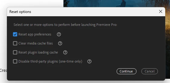

Still having issues? Launch Premiere Pro while holding down the Shift key and check Reset app preferences. This is often the key to solve odd issues.
