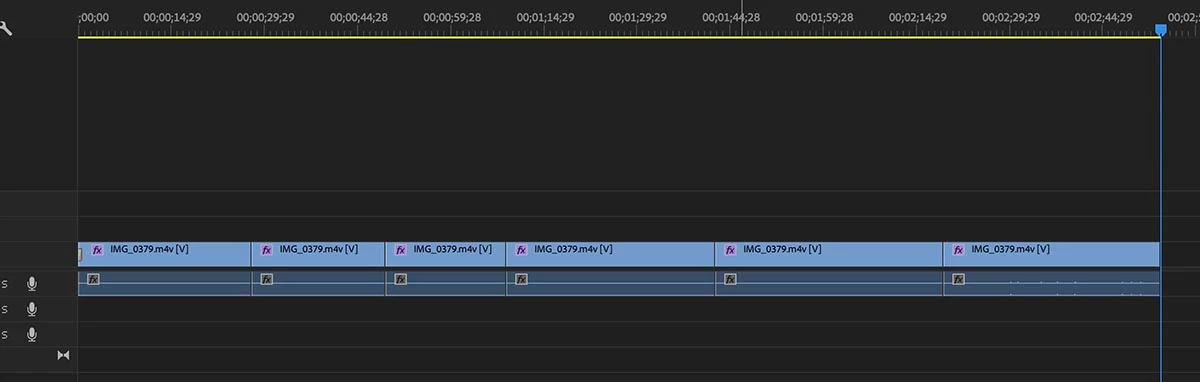

    Here's a screen grab of my timeline.  The total duration is 2 minutes 58 seconds. No single clip is shorter than 20 seconds.  Would this be a problems?

    Which transitions? You do seem to have handles there ... my first (deleted!) response made before engaging brain had it backwards. Little triangles in the corner indicate end-of-clip, and you don't have any, so there should be handles for applying transitions.
    I'm wondering if perchance you have the sequence locked ... is the little padlock icon to the far left of the Sequence header block gray and open ... or closed and blue?
