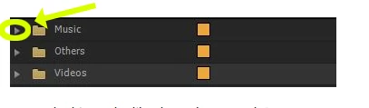

So, I just got PP CC, and I'm having a problem with the bins, I can create them as I always did in CS6, but when I want to close them I can't. I don't know if I'm clicking in the wrong place, but there's the same arrow that I used in CS6 to close them.
As you can see, I droped that video in the bin but I can close it as I did in CS6, like this:
I want the bins to be like that, what can I do?

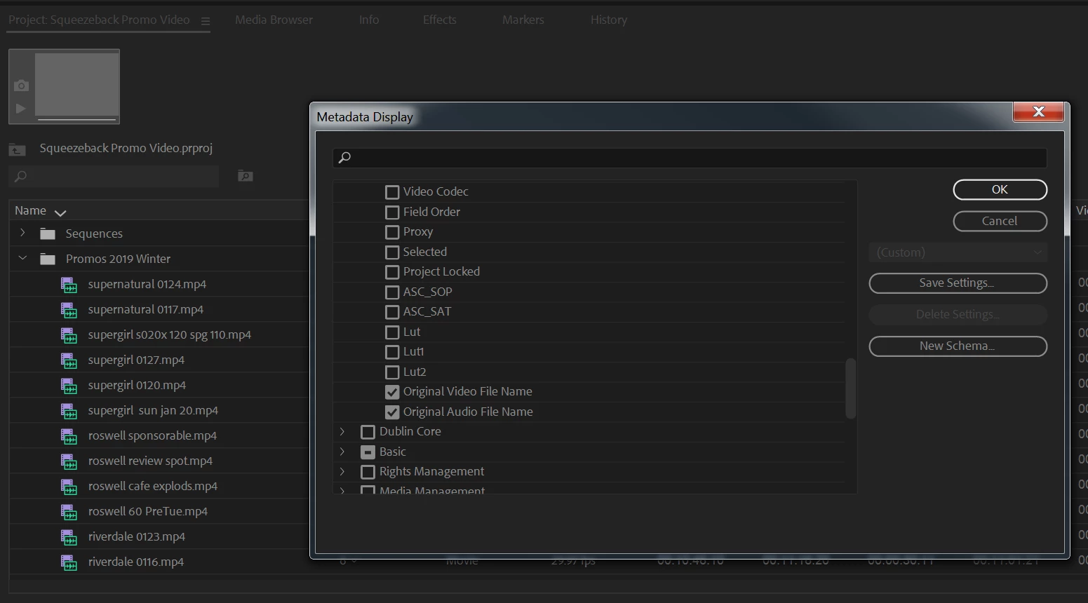

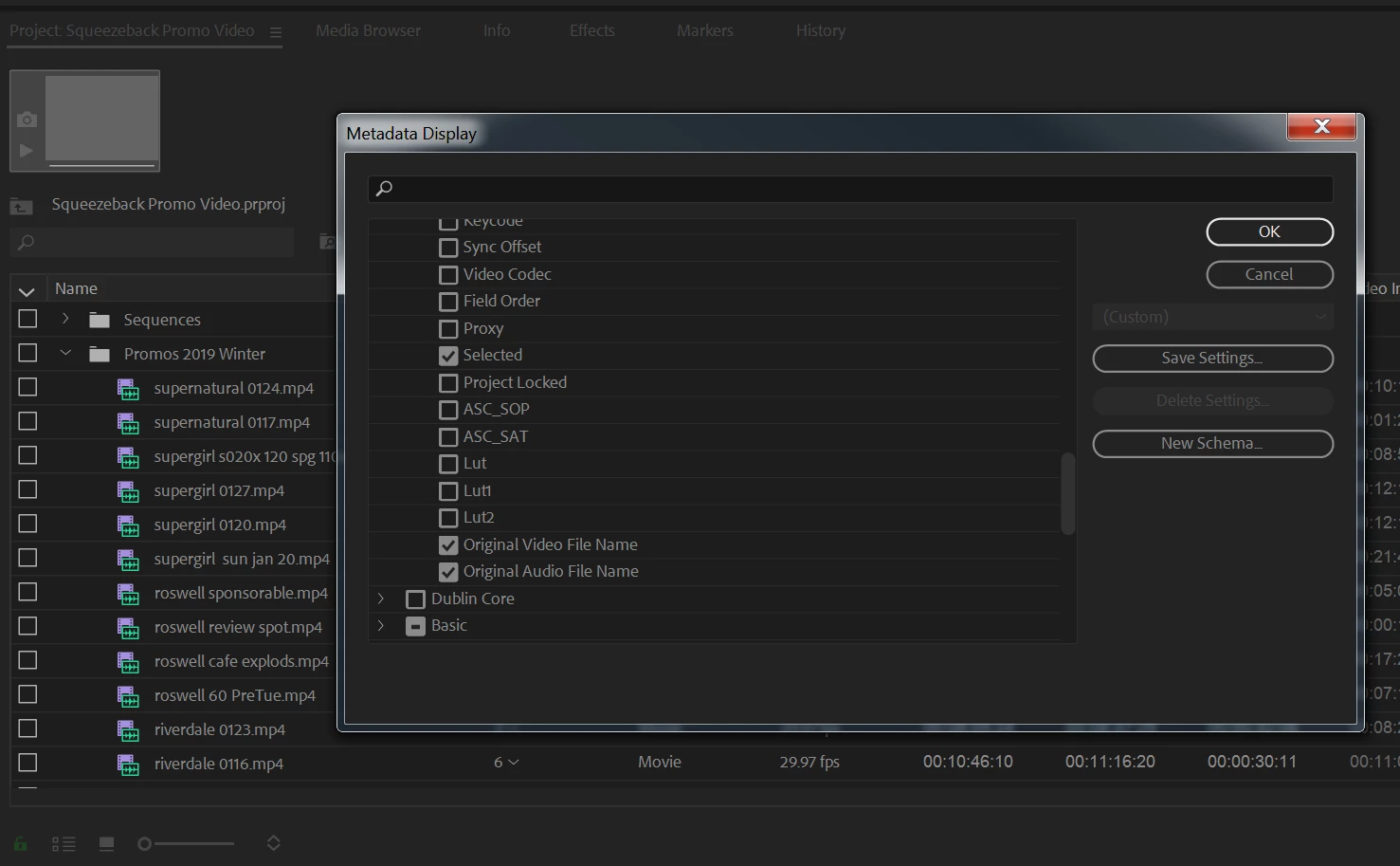

    Winslow Barger
    January 24, 2019
    I had the same problem and found the issue.  Under Metadata Display, if you choose "Selected" under the "Premiere Pro Project Metadata," the arrows won't open and close the bins.  If you see the check boxes to the left of your file or bin name, then you have "Selected" checked.
    When you uncheck "Selected", the check boxes go away and the bins will open and close like you're use to.

    January 30, 2017
    Click on the disclosure triangle:
    MtD
    EDIT: I think I misunderstood what you are asking. Can you post a screenshot of the entire Project Panel?
