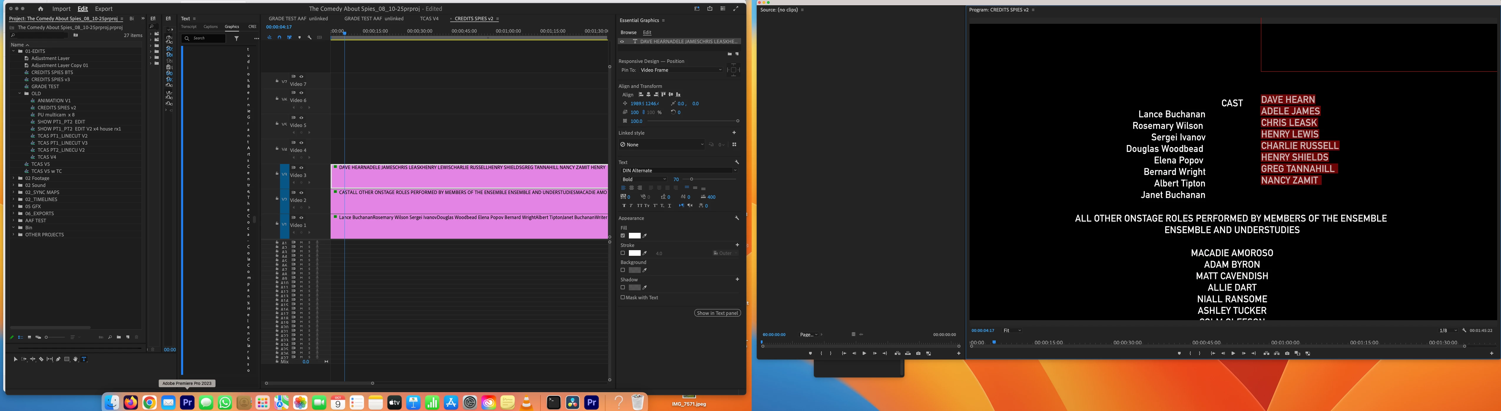

I have just discovered there is a spelling mistake in the rolling credits of my film, unfortunately, it won't let me go in to it and change the mistake.  I have never had this problem before, does anyone know how to get around this.  This is the final step before my film gets sent to the composer, please help as I can't complete the film with this problem.

Got the same problem, cant get back in to amend rolling title. Turned roll off but still now cant get light text to work on it. Red line box shows above text. Have to rebuild outside Premier and change it there before going through the whole process again. Another weird Premier bug that makes you think you're the problem whilst stealing hours of your life. I hate this software

 Hi, I can't get in to the tile to work on it, the red box comes on above and all tiles are high lighted.

Hey there, @claytonsfilms,
Welcome to the community. I read your note. I really appreciate the screen movie you attached. My advice is to launch the Properties panel. Select the text block in the panel, and you should be able to edit the text. Let us know if that works for you.
FWIW, I created a custom workspace docked with the Graphics Templates panel and called it "Properties." This may help you in editing future title creation and editing.
I look forward to hearing back from you.
