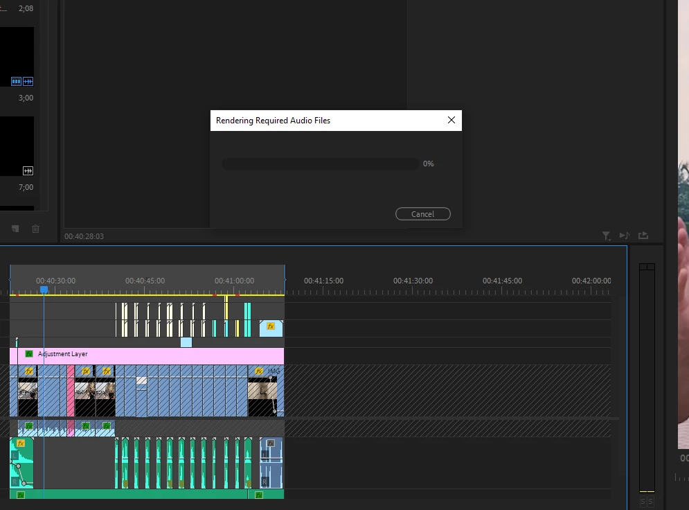

I have a 1 minute video project. When I go to export it, it says "Rendering Required Audio Files" at 0%. I waited about 10 minutes and it was still at 0%
I have the original audio file and also an mp3 song for background music on this short and simple project. I tried converting it to a song to a WAV file but that didn't make a difference. Also my C and D drive are not close to being full, if that makes any difference.
I tried exporting the project without the music audio in it and it said the same thing. I then tried to export the project with out the original audio and then another time with no audio and the "Rendering Required Audio Files" still showed up and wouldn't export.
Any tips would be greatly appreciated!
