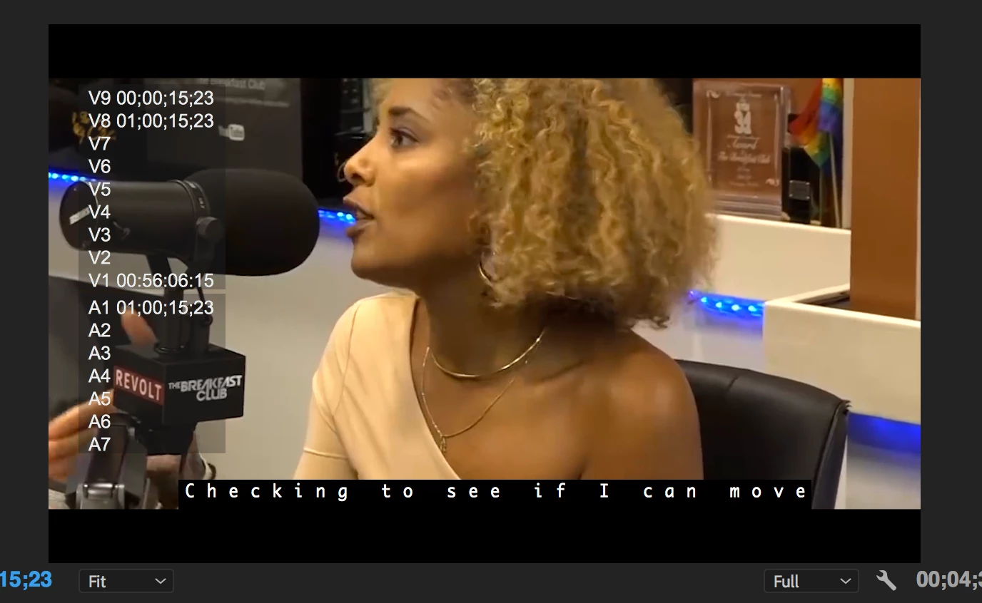

I'm working in Premiere Pro 2018 and I'm trying to move my captions further down so that they are in the black bar on the bottom.
I don't want them over any video above the black bar.

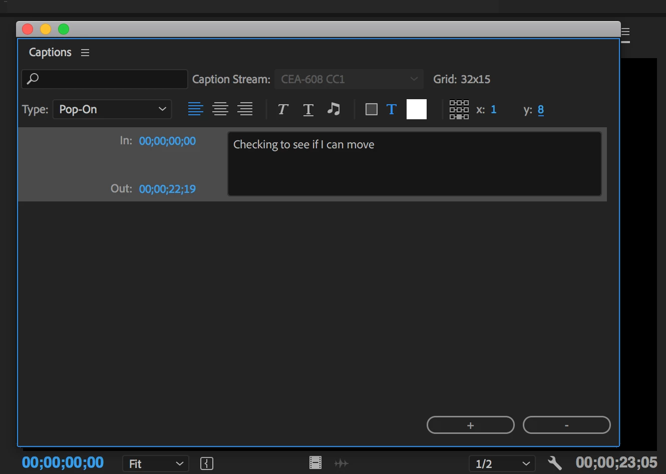

Is there a way to adjust the safe box so I can actually move my captions lower?
It seems I just need to be able to increase my y value higher  but I can seem to raise it, either with my mouse or by typing in values.
Perhaps, this is tied to the safe area limitations? I think the highest I was able to get the Y value was 14 - Sorry, I know the screenshot says 8.

Sorry; I was using my phone and did not see your original screenshots. You are using closed captions, and ultimately they can be controlled (overridden) by user settings on the playback device. In addition to their primary intent as embedded files for closed captioning, they can be burned in or exported as sidecar. But, in any event, they have fewer options of all types (font, color, opacity of background, position) than Open Captions, which are intended to be burned in (and can also be exported as a sidecar).
If your goal is to burn in, you can convert to Open Captions, then the workaround I described using the effect controls will work.
To convert, I would first duplicate the caption stream. Once converted to Open Caption, you cannot convert back. Then select the caption stream in the Project Panel, right click, and Modify -> Captions -> Target Stream Format, Standard -> Open Captions.

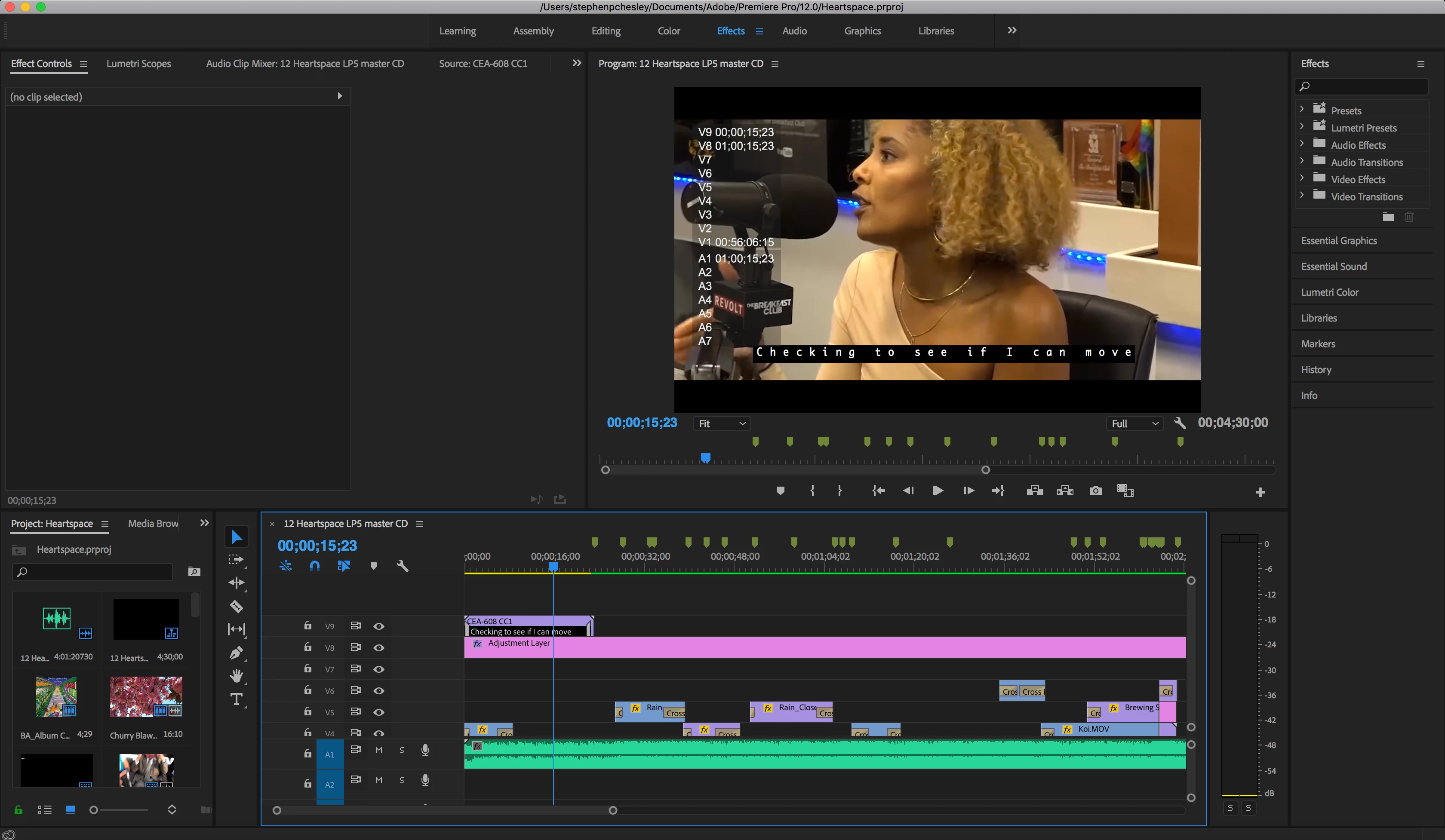

When I select the caption stream in the timeline, nothing comes up in the effects controls like with a regular video clip. I'm not sure what I'm doing wrong or what I setting might be off on my end...

Can you post a screenshot?
