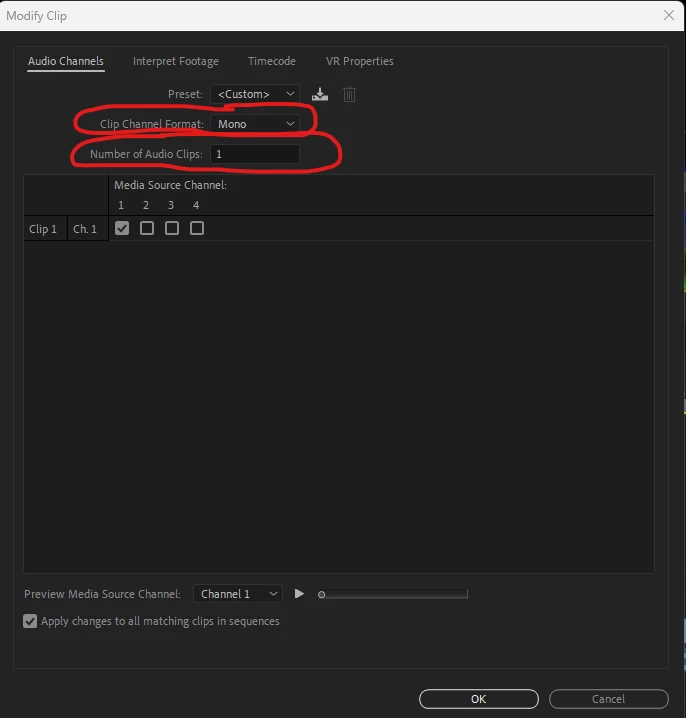

Try this option:
March 28, 2022
when you open up the > Modify > Audio Channels there will be a bunch of check boxes under the heading Media Source Channel. Turn off the 'tick's' in the boxes you don't want audio for ... that's what they mean by disabling (or Un-enable Option)
April 4, 2022
Yes, using the Modify> Audio Channels works, and it can even be done to multiple clips at once by selecting them all.  But importing clips is usually done one at a time, and that means modifying one at a time.  Imagine the extra work involved doing this over the life of the camera that offers these extra tracks.  I contacted Panasonic, and they said they can't do anything, it's Adobe's problem.  I'm surprised that this hasn't been addressed before, because this isn't the first camera I have had that automatically offered over four to eight audio tracks with each video clip imported.  Surely no one but a huge audiophile or a major film studio wants all these audio tracks.
