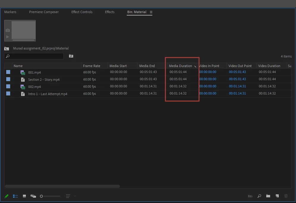

Jun 17, 2022 9:01 PM UTC
Import all the recovered files, put them in the same bin as offline files, arrange the files by media duration:
Then relink each file with the one that has the same duration. (Hoping that most of the files have unique durations 😉)

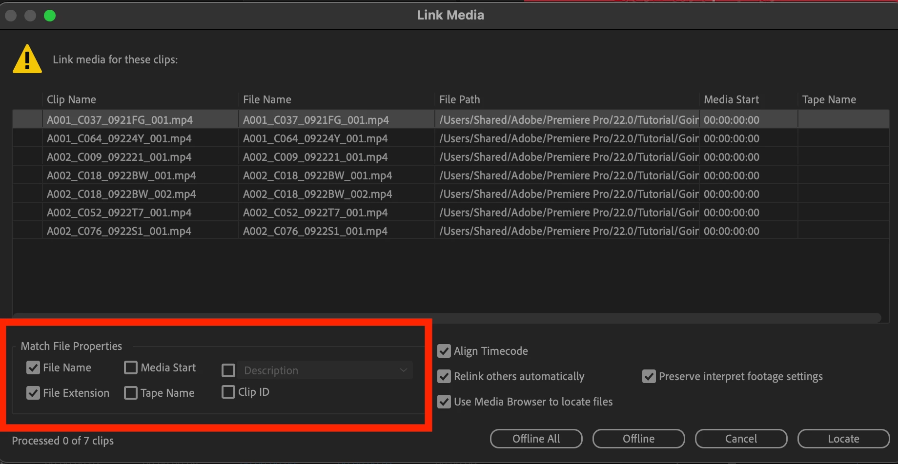

Jun 17, 2022 3:48 AM UTC
If you Make Offline your media, then attempt to Link Media, perhaps you can use one of the other paramters to match your clips. Otherwise, this may be a manual linking job.

Jeff Bugbee
Jun 17, 2022 1:28 PM UTC
I don't know how large your project is but generally, when I edit something, I get to know the footage fairly intimately, so if I were to offline all my media and rename all my clips, I could theoretically go through and relink them one by one just from previewing them and remembering which was which based on how I had them arranged on the timeline. Certainly easier than recutting.
