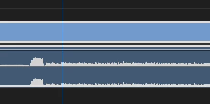

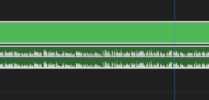

    You can add the audio file to its own sequence, increase the volume of the sequence mix (inside of "audio track mixer") and add some compression (to normalize the noise levels), then drag that audio sequence into your main timeline. Waveforms will be enlarged.
