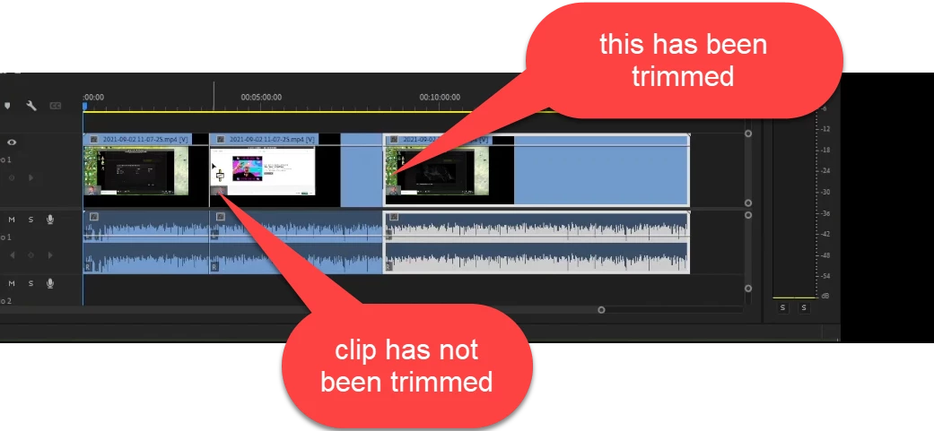

September 3, 2021
The transition on the left is working, but you are not seeing it as the clip has not been trimmed just cut.
Frames on both sides are the same.

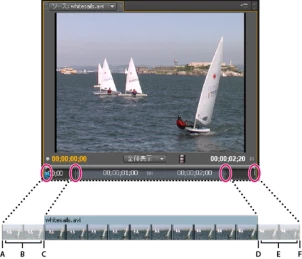

Transitions need handles:
