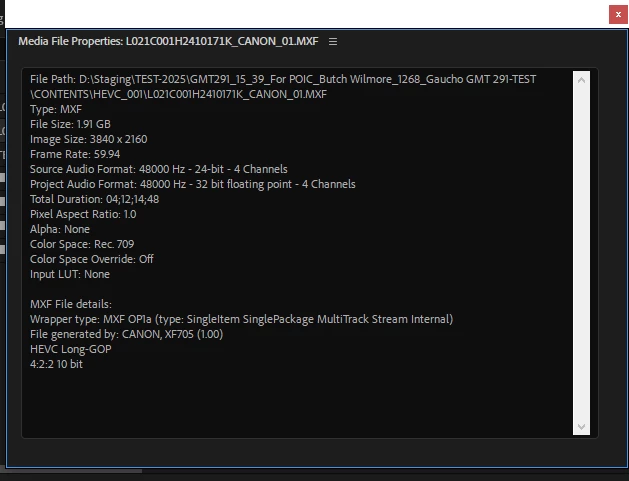

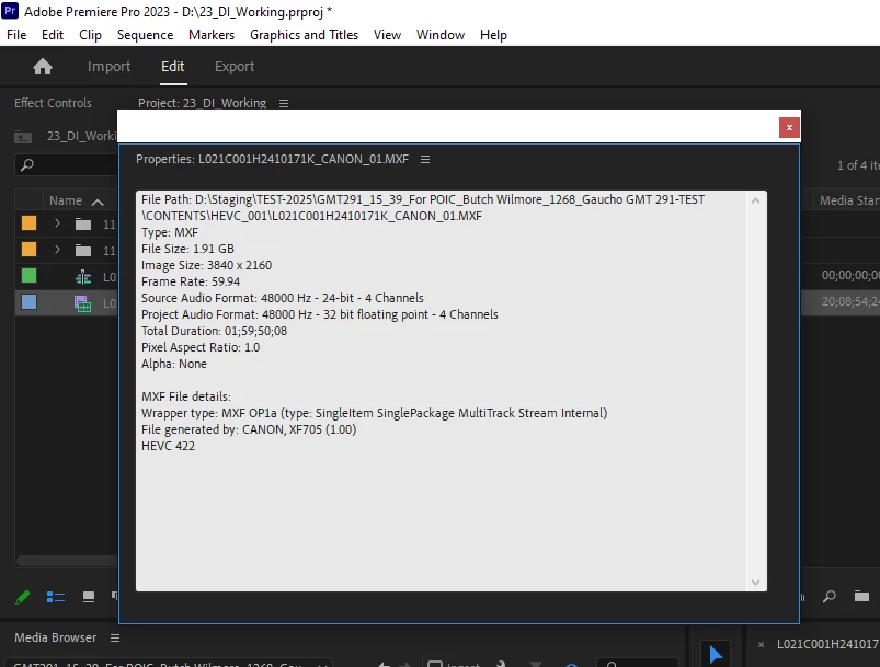

November 25, 2024
The Camera is on firmware 8.4.3.1.00.
First, the media file properties from 2023:
[Adobe Premiere Pro 23]
Second, same clip in 2025:
[Adobe Premiere Pro 25]
