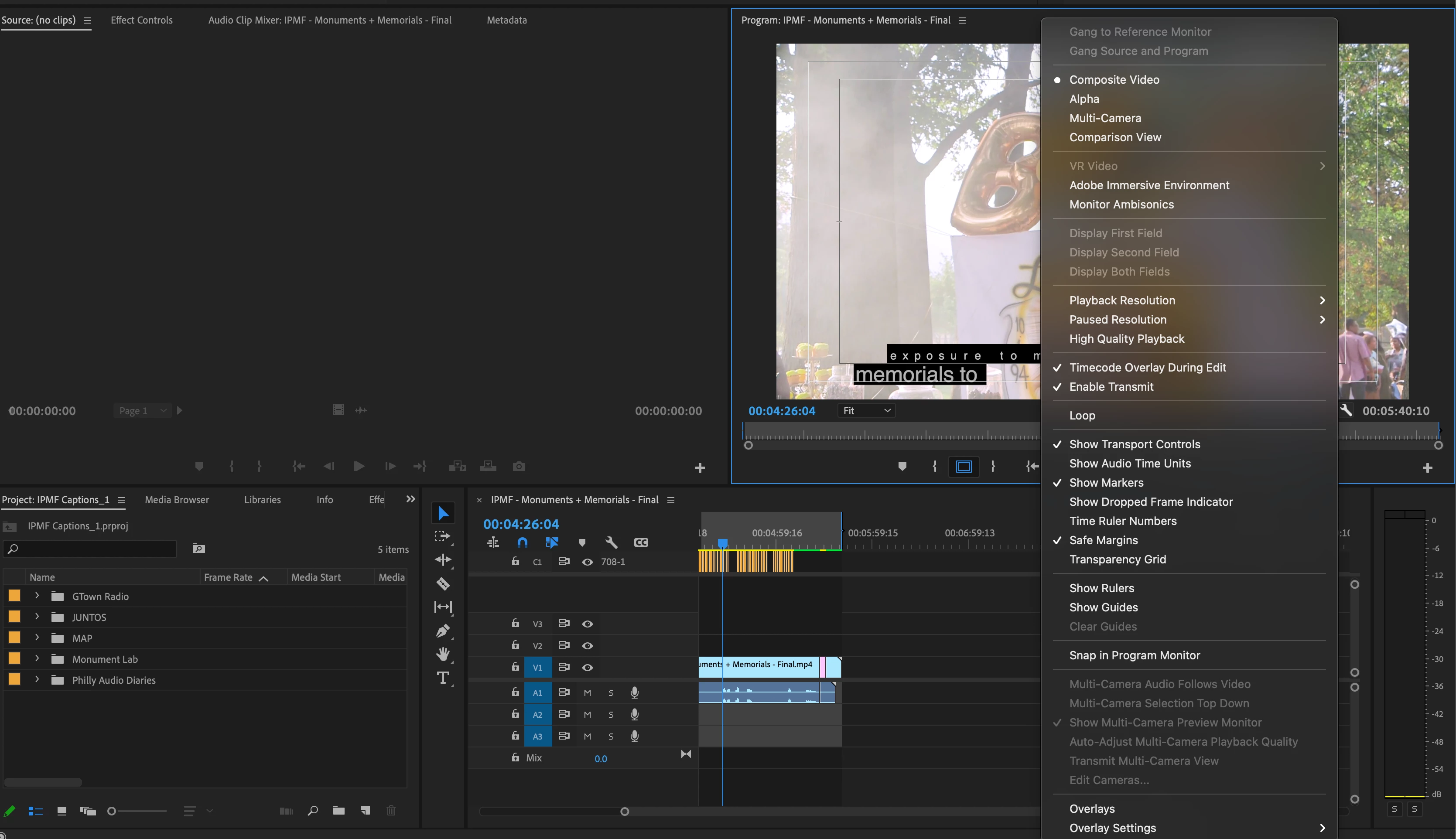

Hoping this is still an active thread.

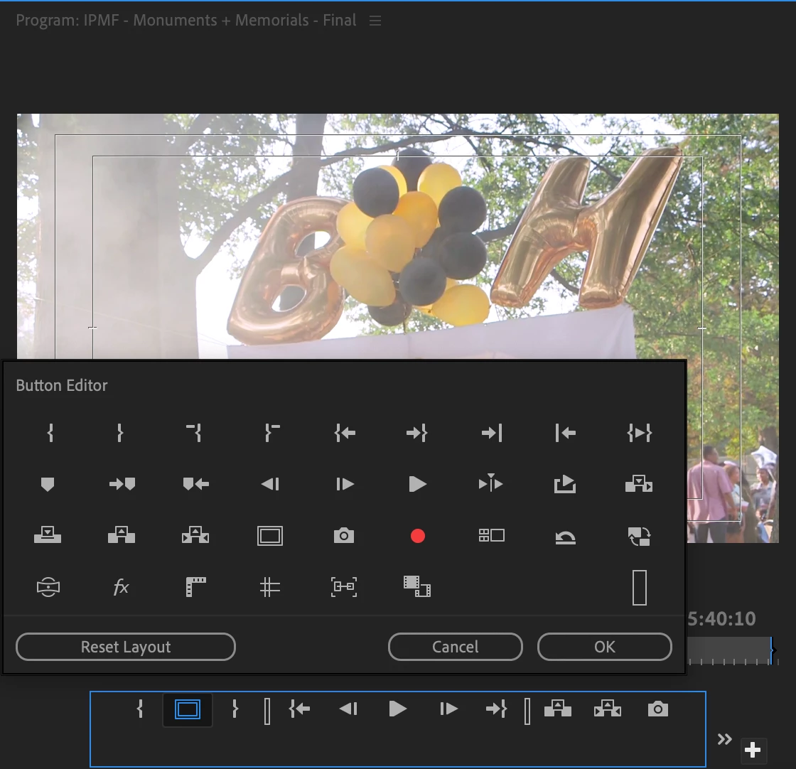

I know how to add captions and already made captions for this project. It's an older project from last year and I had to go in and update some credits in the project. I'm trying to re-export but I'm seeing both my open and closed captions on the screen.
There is no option for me to turn off Closed Captions display using the wrench tool in the program monitor, and there is no button for captions in the button editor. Very confused, because I've done this before and been able to toggle it on and off.
See attached pics.

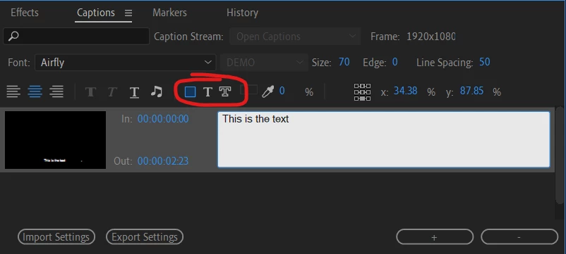

I stumbled upon this problem and I thankfully got my problem right
you have 3 options within the red circle. the BG color, Text color and edge color. what I did was made the edge opacity zero (eye dropper) and the caption was now visible. in my case even if the edge color was on 1% it would not show the text(compare to 1st picture where the edge color is zero)

It could be that your captions are not "enabled" in the Program Monitor. If you click on the wrench icon under the Program Monitor, you can go to "Closed Captions Display" and then click Enable. [screenshot attached.]

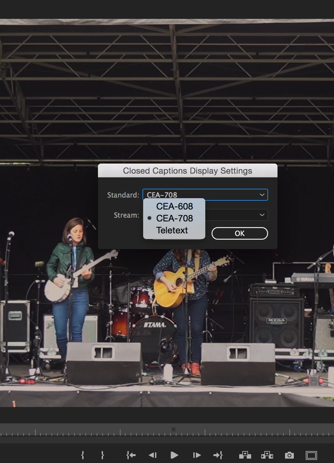

If that doesn't do it, what kind of captions did you create? If they are "closed-captions" either 608 or 708, then you may have to go to "Settings..." under the Enable option, and change the setting to match. [screenshot attached.]
I hope that helps, and good luck!
